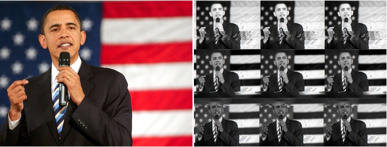

I followed those instructions, applied WahWah effect, and got this:
Wah-Wah Elvis matches the video, I must have done something different :

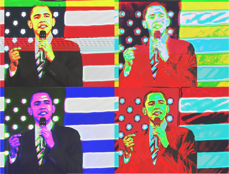

somehow* I’ve split it into R G B channels producing the white/normal/dark Obamas.
The video tutorial said U-law, arkmabat said A-law, maybe that’s the source of their problem, (evidently it’s not Audacity’s fault).
- I omitted to select “planar” …

Selecting the “planar” option when exporting from Gimp gives you all the “red” data first, then the “green”, then the “blue”.
The “normal” (RGB) option gives you an audio file containing RGB values for each pixel in order, starting from the top left corner, then scanning left to right working down the picture.
So if you want to operate on colour channels, chose the “planar” option. If you want to work on the image in “top to bottom” fashion, select “normal” (RGB).
The images are surprisingly robust : it takes a lot of "moshing"in Audacity before they become unrecognizable …
8-bit unsigned seems to work pretty well.
Here’s a bit of “channel moshing”
The inverted part of the image was by “reversing” part of the waveform.
The colours were enhanced in Gimp for the final image.
