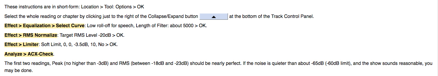

That’s not the Audiobook Mastering Suite.
The official posting is here:
And the abbreviated version is this:
When you read, your first action when you get to the last sentence of a chapter is File > Export > Export as WAV (Microsoft) 16-bit. That’s your protection sound file if “Anything Happens.”
MarysLittleLamb-Chapt1-RawRead-2019-12-06.wav For example. Do not use punctuation marks in filenames other than underscore and -dash-. Use the ISO version of dates as in that example. No slash marks.
Do Not use MP3 for anything until the last step when you prepare the work for submission. Use WAV. MP3 creates distortion each time you save the work, it gets progressively worse, and it’s permanent.
So go over the work again, or a test, and include all three steps. The first step, equalization, is going to be different when you shift to Audacity 2.3.3. That’s just the way it is in product upgrades. Do Not upgrade anything until we get this settled.
Make sure you have the track selected with the button on the left when you apply the tools. That may be what happened to you. As I said above, it’s should be nearly impossible to get RMS and Peak wrong with the Mastering Suite corrections.
Let us know.

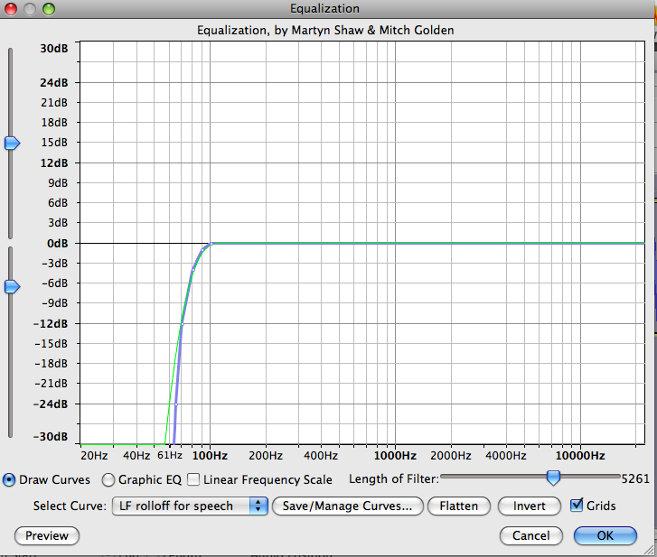

Maybe, but there is a way to add Low Rolloff to earlier Audacity versions. It’s not that complicated. It’s a rumble filter.
Home microphones sometimes have sound errors down in earthquake, thunder and large truck tones. This filter is designed to get rid of most of them in addition to actual thunder, trucks and earthquakes. This can be important because those tones can mess up the other tools and, of course, most times you can’t hear that the problem is because the pitch is too low.

LF_rolloff_for_speech.xml (299 Bytes)
LF-Rolloff.txt (1.79 KB)
The XML file is programming you can add to your Effect > Equalization to produce the rumble filter. It’s correct in spite of being a different name. That was the original development name when only the techies had to worry about it.
The text file is something I apparently wrote to explain how to install it [blowing off dust].
When you get done installing it, run it according to the instructions in the mastering suite and it should give you a curve that looks pretty much exactly like the above picture file. It’s not important to hit the Length or quality of the curve exactly. 5000-ish is OK.

Effect > Equalization according to the instructions in the mastering document and your fresh, exciting, new LF curve.
