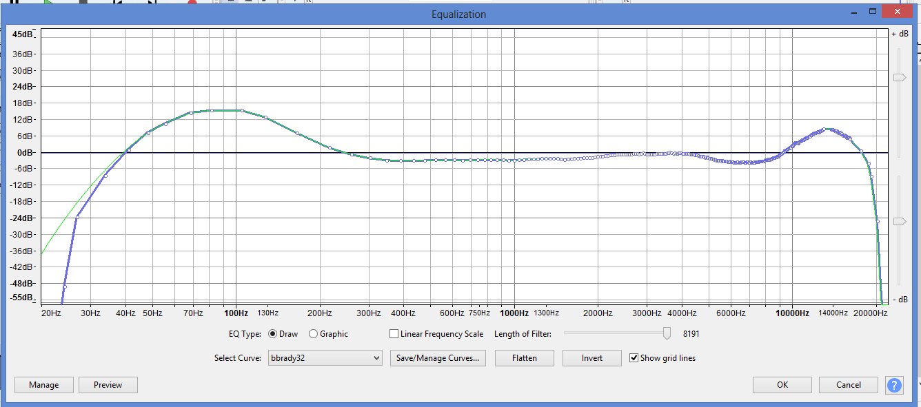

Here is the equalization I used …
bbrady32.XML (19 KB)

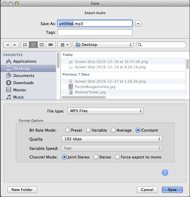

I can’t convert my wav files to mp3

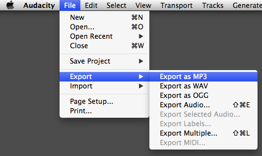

You said up the thread you’re in Audacity 2.3.3.
Open a performance in Audacity.
File > Export > Export as MP3.
192 - Constant is the minimum allowable MP3 quality for ACX. If you’re presenting in mono (one blue wave) the channel mode doesn’t make any difference.
There is a split here. Some will insist that you select Force to Mono. That can get you into trouble. If you have to deliver to a client in stereo, you have to remember to de-select Force To mono or the client will not get the stereo show they paid for.
ACX recommends strongly that you post in mono. So your decisions in post production editing (Stereo or Mono) should determine the delivery, not an unusual MP3 export setting. I should leave it in Joint.
