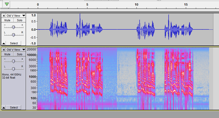

Ok, here we go. I hate to add in yet another element, but I’m going to have to return “my” mic eventually. Before I do though, Here is the old and the new. If we like to old better, maybe my friend would be willing to let me buy it from her and I could return the new. I think it’s sounding pretty good though. What do you think?
The new mic is much better: a night & day difference …
You’ve also successfully managed to silence the room reverb.
The new mic will pass ACX without any processing to reduce the noise-floor,
but still I’d be tempted to use a hint of couture to take the noise-floor down to -70dB.
