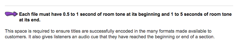

One other reader went through all the thunder and lightning of getting the sound quality just right and they, too, were bounced for putting the wrong number of seconds of room tone in. Getting that right is a big deal because that’s the only way to accurately measure background noise and that’s the specification most home users fail.
ACX publishes detailed submission requirements and they’re not all weirdly technical. Audacity publishes ACX Check which is a software simulation of the tests ACX is going to do after you submit.
https://wiki.audacityteam.org/wiki/Nyquist_Analyze_Plug-ins#ACX_Check
These are graphic excerpts of the actual ACX publication having to do with sample details.
