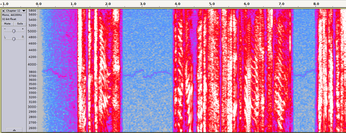

Don’t bet the farm on that. There is no known cure for an essy microphone either before or after narration. I would give anything to be able to tell people which towel to throw over the microphone to stop it from doing that.
Essing has very clear symptoms in the Audacity measuring tools, but none of that measuring and testing has resulted in a way to get rid of it.
Read this illustration as increasing pitch left (thunder and earthquakes) to right (air-leaking-hiss and tinkly bells). Louder is up.
That lump on the right is artificial. Your normal voice doesn’t do that. I know you’re saying to yourself now, “Well, just get rid of it.” It didn’t work. If you use the normal sound tools to make that go away, your voice turns into talking-under-a-blanket mud. There has to be voice content analysis algorithms and that makes my head hurt.

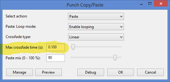

I used the copy punch paste feature to put the room tone in those areas. Ok wav snippet attached. I sure hope these will work because I am over half way through a 60,000 word novel for FindAwayVoices. However I think I’d improved A LOT from the original sample I sent ACX which I cannot find now, I don’t remember which sample I sent them which is really bad cause now I can’t compare for improvements.
They took a long time to get back to me and so with an author waiting I just went with recording and hoped for the best.
I put room tone over almost every breath sound unless they’re in the middle of words in a sentence. I don’t like hearing them before new sentences so I doubt listeners will either. Is there a better way to deal with that?
The cross-fade time is too short causing the ends of words to be clipped off,
which is giving the game away that that technique has been used.
I’d use at least 100ms, (0.1 seconds), cross-fade time to hide the joins.
I’m lost on that. I’m not hearing the ends of my words being chopped off. It’s weird too cause the author has proofed this and she didn’t notice it either. I guess I need to read up on the cross fade cause I’ve never heard of it and don’t know how to use it.
Can I do this to the areas I already pasted the room tone into or do I need to redo everything to fix this. For the love of god please say it’s still doable. Lol
