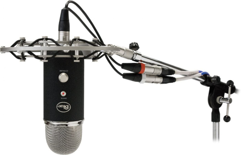

The Trebor picture above features the vibration and shock mount. The microphone is literally floating on rubber bands to keep mic stand, floor and desk vibrations away from the sound.
I made one a bit ago from plumbing pipes and postal service rubber bands.
Those are both microphones where you talk into the end rather than the side, but you get the idea.
