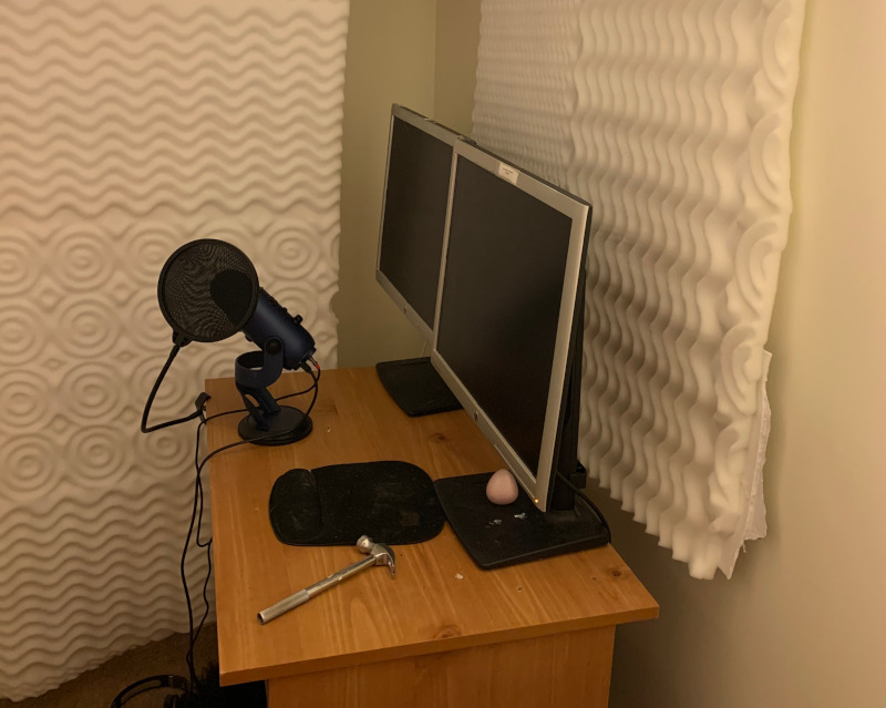

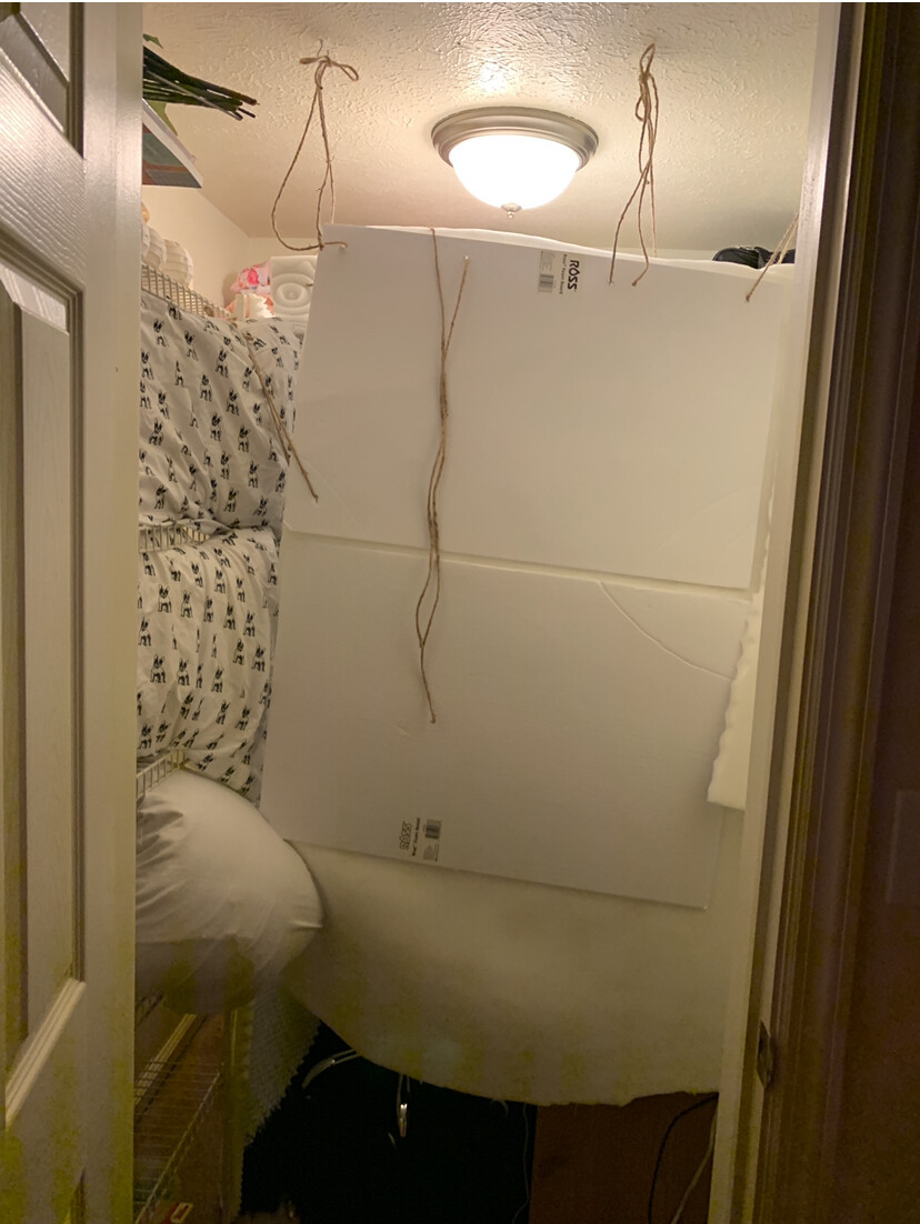

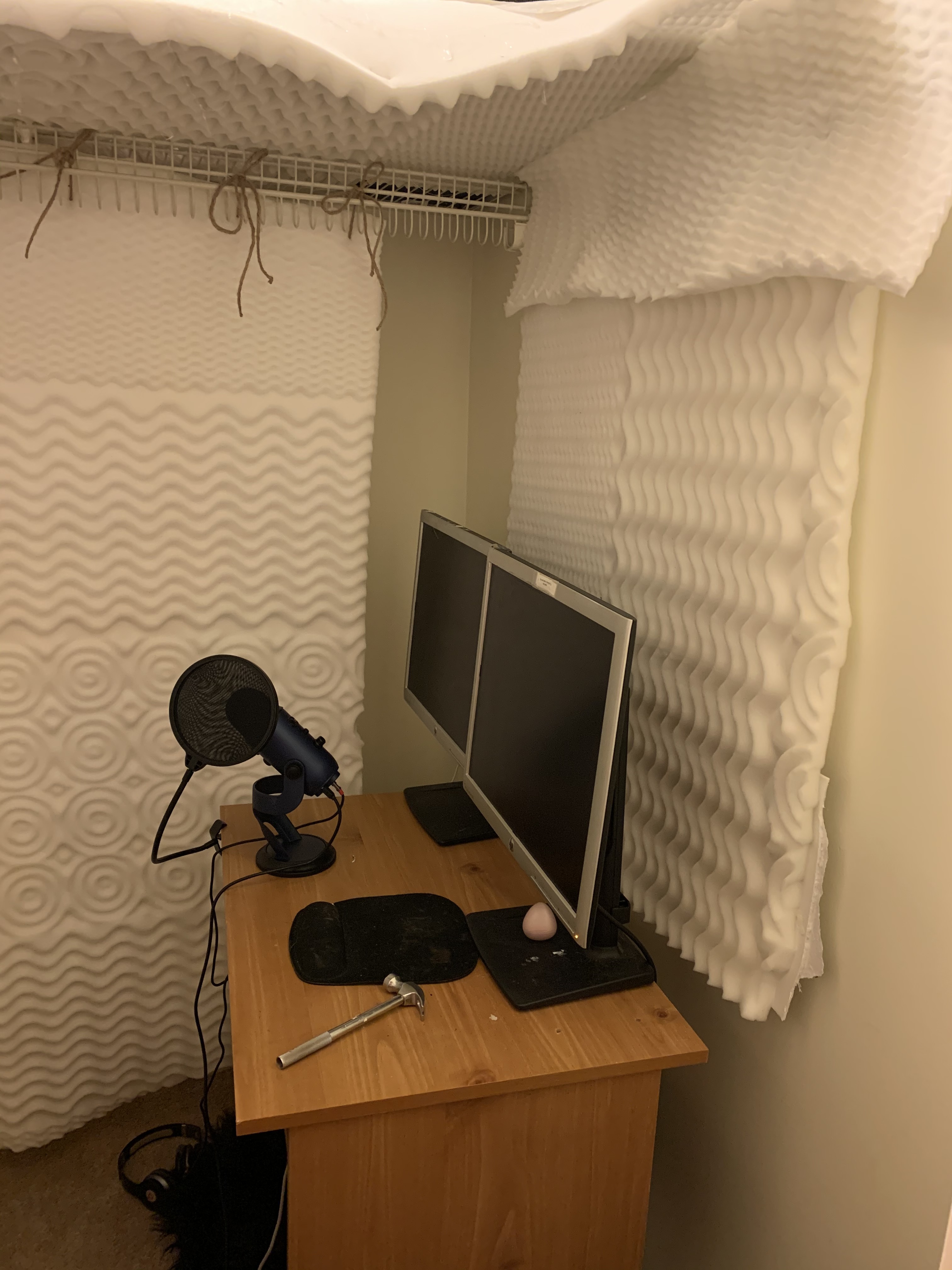

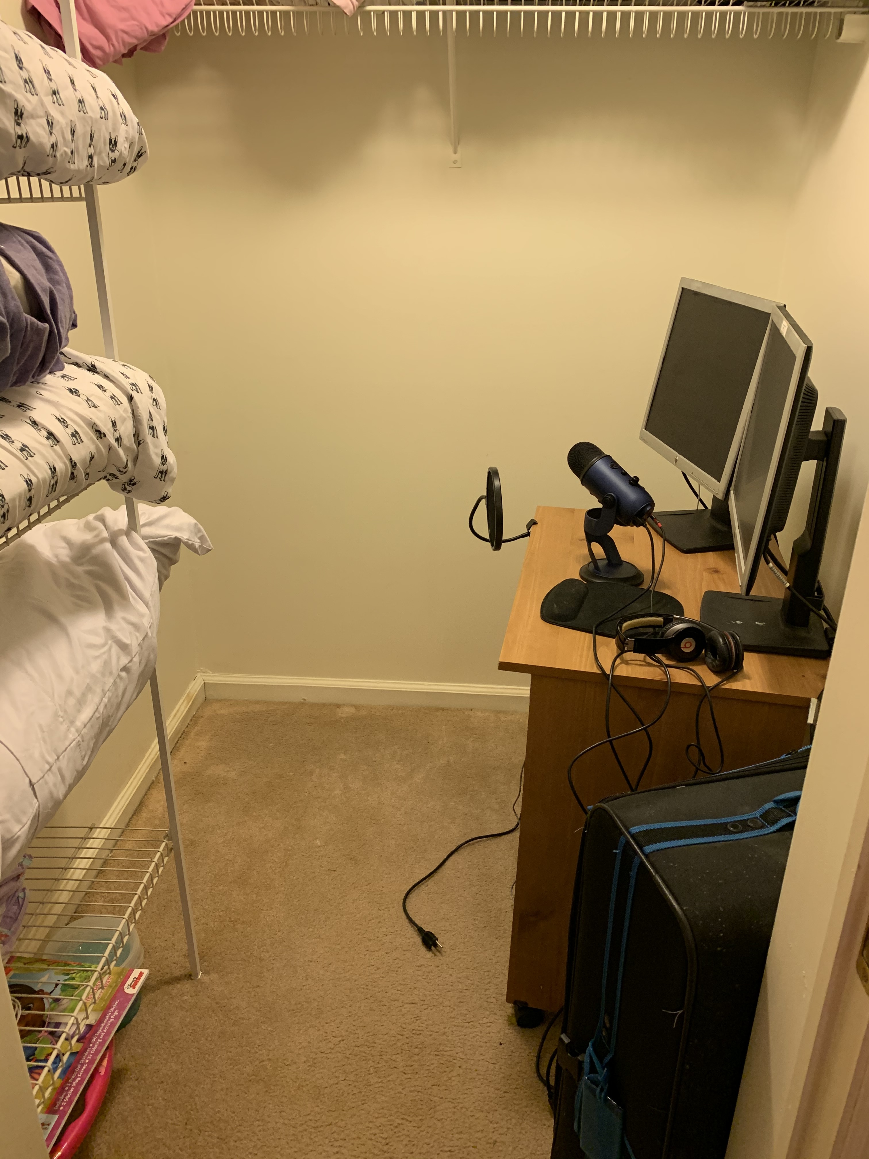

Ok so perhaps I overdid it on the closing myself in. I didn’t just pad the walls in here, I created new ones and they are very close to my body on all sides. Foam-backed with foam presentation board. should I maybe move it back? Or just go back out into a big open living room to record where I started? lol
I couldn’t play the second non boxy sample you sent for some reason it just kept taking me back to the first page of my post when I clicked it.
Will this cause me to fail the human test with Findaway do you think?
I’m attaching pics. Basically I am in a box. Would it help if I just took my box apart and put the foam on the walls a ceiling directly?
Here’s the last pic of it all closed up.
Or were you saying that my first sample didn’t sound like I was in a box but the second one did? They were both recorded in the same exact space.

“(843.17 KiB)” does sound like there’s a highly-reflective surface close by causing the boxy sound.
From the picture, the screens and the desktop are the only near hard surfaces …
Possibly angle the screens so you can still see them, but they are not reflecting your voice back to the microphone.
or change the position of the microphone so it’s at forehead height …
The Yeti microphones have a switchable sensitivity pattern, cardioid is the one to use to minimize reflected sound.
