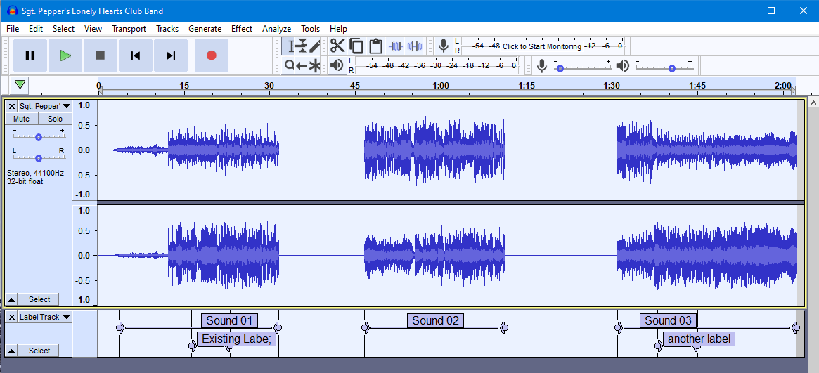

Hi Christian,
works for me:
BUT only if I select just the audio track. IF I select the audio and label tracks THEN it fails to work.
This looks like a minor bug to me - I’ll need to test to see if it’s a regression (i.e. worked in an earlier Audacity version) - and if it’s not logged already I’ll log it on Muse’s bug log on GitHub.
I’m not sure what expected/desired behavior is - but is should work and either create a new label track or add the labels to the existing label track - I can see benefits of either way.
Peter.
Christian,
well it certainly works in 2.4.2 where, if you select both the audio track and the label track the Label Sounds adds to the existing label track:
So this is indeed a regression - I need to do some more work to find which release introduce the bug before logging it.
Peter.
It’s a regression on 3.3.3, introduced in the recent 3.4.0
I’ll get on and log this later.
Good catch Christian, many thanks for the report ![]()
Peter
