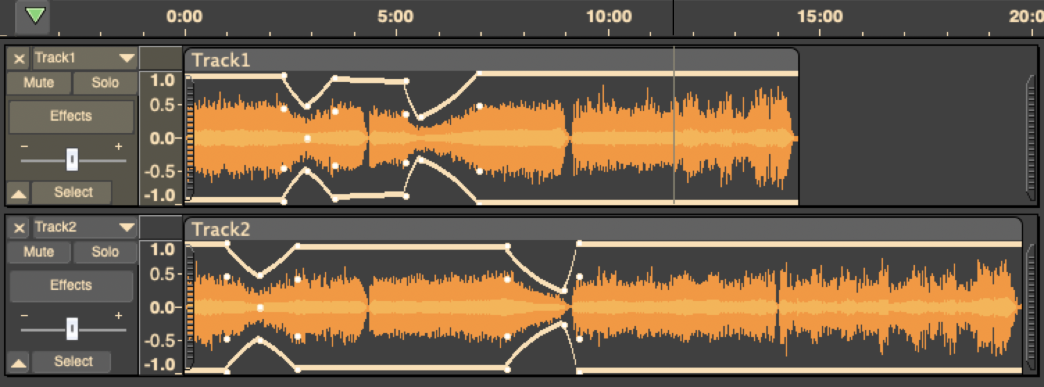

I cannot reproduce the problem with a new project with “raw” audio using Audacity 3.2.1 on a Macbook Air running macOS 13.0.1. For example:
Before deleting audio from Track1 (using the Multi-tool so I can watch the envelope points while editing the audio)
After deleting some audio in Track1
