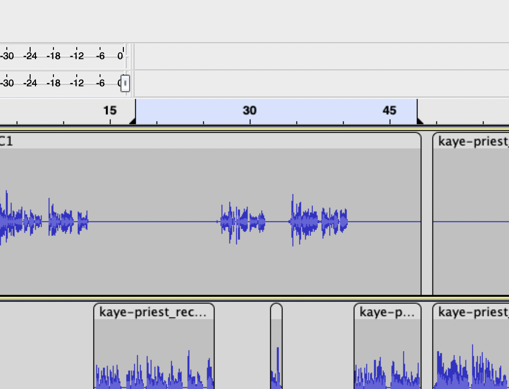

I probably need to do a new thread for this next issue - unless I am somehow inserting this playback loop without realising it…?
Every now and then (again, no obvious rule as to when this happens and it is occasional) - a playback will form like this (see the blue highlighted section on top of the top track in the picture).
So that I can work out if it is a bug (or my mistake) - please can you tell me how you would normally create these ‘loops’ on a track?
Secondly, how do i go about deleting / removing them?
thanks again,
Anna
Right-click (or two-finger tap on a trackpad) then select “Clear loop” from the menu.
The looping region is created by dragging in the timeline.
– Bill
Thanks Bill. Have removed easily and have a feeling this could be my error in creating it manually - will keep an eye on it!
