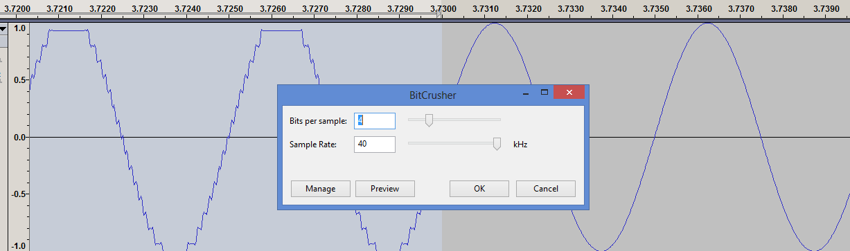

I used Nyquist’s resampling rather than a sinc filter as sinc filters are extremely slow prior to the latest big Nyquist update.
As you are using a version of Nyquist that predates the last big update, could you check that you get the expected number of “steps” for the selected “bits per sample”. For example, if set to 4 bits per sample, and the sample rate is set to maximum, you should see 16 distinct steps over full-scale.
Resampling occurs after bit reduction, so the “steps” are bandwidth limited. At lower sample rates you should see that the steps are smoothed.
Do you think it’s worth adding an option to resample before reducing the bits per sample? (Doing so mostly sounds horrible :smiley:)
If you want to try that, change the last line from:
(qrate (abs-quantize *track* bits) rate)
to:
(abs-quantize (qrate *track* rate) bits)
Yes: 16 treads when set to 4 bits per sample …

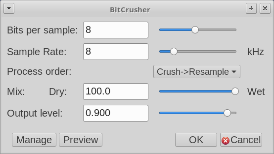

How about this:
Parameters:
  • Bits per sample: [1 to 16 - default 8] Number of bits per sample.
  • Sample Rate: [1 to 40 kHz - default 8 kHz] Effective sample rate.
  • Process order: [choice: Crush->Resample, Resample->Crush, Crush Only, Resample Only - default “Crush->Resample”]
    “Crush->Resample” means, reduce the bits per sample first (bitcrush) , then resample.
  • Mix: [0 to 100 % - default 100%] Dry / Wet mix. 100% = wet (effect only). 0% = dry (unprocessed sound only)
I’ve also fixed the scaling / offset so that the steps fit in the range +/- 1 and zero (silence) remains at zero. To do this, there has to be an odd number of steps, so the number of steps is now: (2^bits) - 1
1-bit has to be handled slightly differently because having only one level would be silence. Thus 1 bit is rendered as +1 for positive input samples, and 0 for sample <= 0.
8-bits: 255 levels
4-bit: 15 levels
3-bit: 7 levels
2-bit: 3 levels
1-bit: 2 levels (0 or 1)
The plug-in:
BitCrusher.ny (1.74 KB)
For low bits per sample it makes sense for the input audio to be normalized to 0 dB so as to get the full bit-range, but then the preview will clip. So I’m wondering if it would be best to add an output level control (default to say 0.9).
What do you think?
Working as advertised.
I would end up using a (hard) limiter on it anyway, so sounded as loud as the original …
But it seems logical to give users no-clipping as the default.
With an output level control:
And the plug-in:
BitCrusher.ny (1.83 KB)
