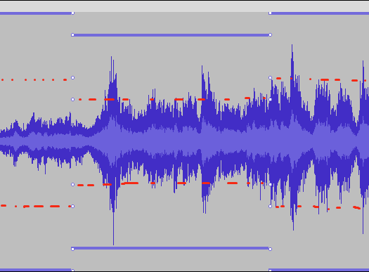

Since updating to v3.6.0, the lighter inner band/boundary for the “inner handles” when using the Envelope tool or Multi-Tool is missing, so that audio tracks are all one color (except for the waveform). It’s the exact same problem described in this older thread, though in this case the inner band doesn’t appear or disappear whether or not the track is selected. I can’t find a view option to bring it back. Is this a bug, or a setting somewhere?
First pic = how it should look (previous version)
Second pic = how it currently looks (red dotted lines added where inner boundary should be)
handles-in-light-mode

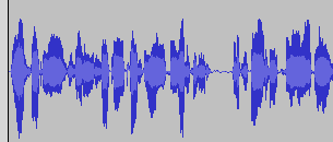

Where did the light blue in the center of audio clips go on classic? D:
That’s the “RMS” option; it was disabled by default by the update (this annoyed me too until I found how to fix it). You can turn it back on with View → “Show RMS in Waveform”.
And note that this setting is NOTreset by using the Tools > Reset Configuration Command.
It is reset if you do a total reset by purging your Audacity settings folder.
Peter
Oh, perfect, thank you!

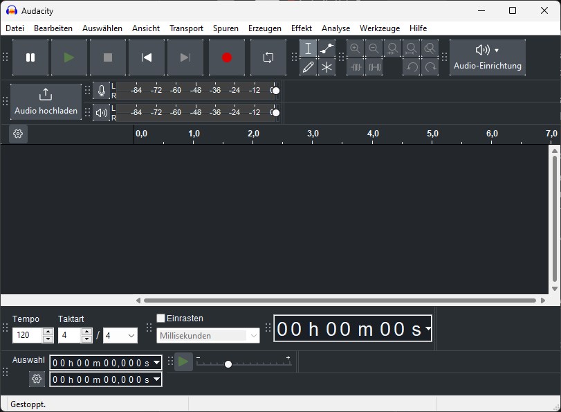

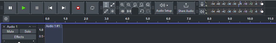

I was excited when I read “new and improved dark and light themes”, but actually it looks like semi-finished with all the light elements.
Those light elements depend on your Windows desktop theme (light or dark):
Makes the dark mode kinda unusable for me, sadly; the contrast between the dark and dazzlingly bright bits is uncomfortable, and my custom Windows theme requires light mode to work, so I can’t switch it.

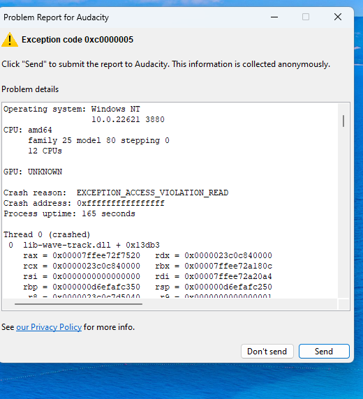

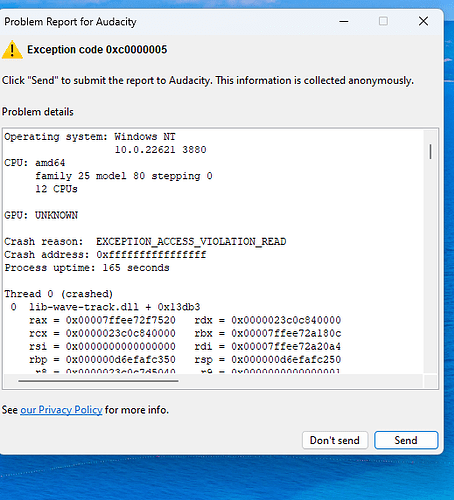

Downloaded the new “3.6” update and instantly ran into problems:
During the process of exporting a four channel files to a single FLAC file, the program crashed, leaving a ‘crash file’. using the option to send the ‘crash report’ itself failed!!!
I will attach the report at the end.
A second attempt at performing the conversion has left the whole program in a crashed situation, with the whole screen looking as though it has done a ‘white out’.
Crash Report:
Crash Report.txt (97.9 KB)
