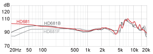

How can you tell, that’s all in Chinese, at least on this side of the pond. Even Google Translate can’t seem to make hide nor hare of it.
It does have a frequency response chart that looks relatively flat, but I’m not quite sure how they came up with it. The ones I’ve seen for microphones have a zero center line on the vertical scale. This one seems to center on around 95 to 100 dB.

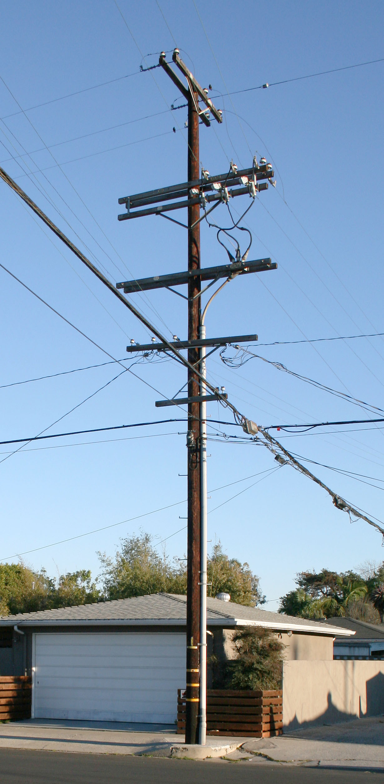

That’s the theatrical description of the problem, but it’s absolutely true. If you walk into my third bedroom at night, your ears pop from the quiet except the very tiny window leakage from a metrobus driving by. All my equipment is properly grounded and there isn’t enough of it on the desk to have ground loop or other wall power problems. And yet. When I press record or go into Monitor mode, there is classic US-version AC hum in the show. I used to think I had broken microphones, but they all work perfectly somewhere else.
http://kozco.com/pix/PowerPole.jpg
I’m guessin’ radiation from the overhead power lines. Literally flying through the air.

Seriously though, I was surprised to learn how much power leaks from those lines. I remembered reading that if you hold up a fluorescent tube under power lines it will begin to glow. I just googled it & found some interesting images of glowing fluorescent tubes under power lines.
Maybe you could build a Faraday Cage around your house, eh?
Too late. The house is classic California stucco with metal lath underneath the stucco. I have trouble getting wifi in the back yard and for years I thought I needed a roof antenna because TV reception inside sucked. No. It only sucks below the attic because that’s where the stucco and lath is. The attic TV antenna works a treat. Signal Strength 100%. Signal Quality 98%.
When I get a second, I’m going to make a “fake” microphone without a shell shield so it intentionally hums, and then go looking for the source. I can wave a normal microphone around and get the interference to come and go as if it was in blobs around the room. 'There’s a peak by the credenza and it’s oriented roughly north-south.
Classic radiation interference.
Maybe not the 3000 volts in my neighborhood. That’s pretty tame. Yes, the interstate lines can do that.
Somewhere here I have pictures of one of the transmitter techs at WRC-AM standing next to one of the towers with lit tubes in his hand. That’s an old crowd-pleaser for visitors. I didn’t get to do that. Mine was FM and TV. Our stuff was at the 660 foot level of the tower.
Still, it is annoying because that’s the quiet room of the house. Maybe if I teach it the words.
