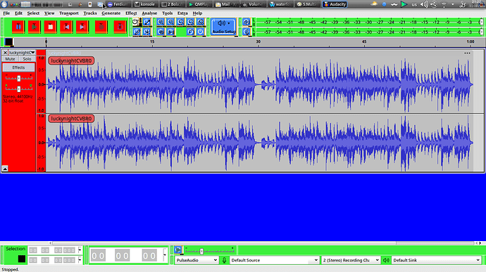

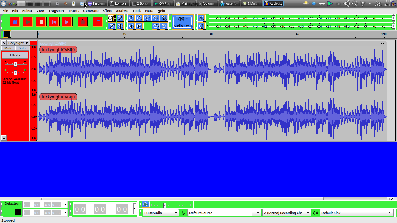

I just tried that theme in my new local build of v3.5.1 (I have my reasons for trying that version), and get this psychedelic look:
Not exactly the improvement I hoped for over the built-in Classic theme:

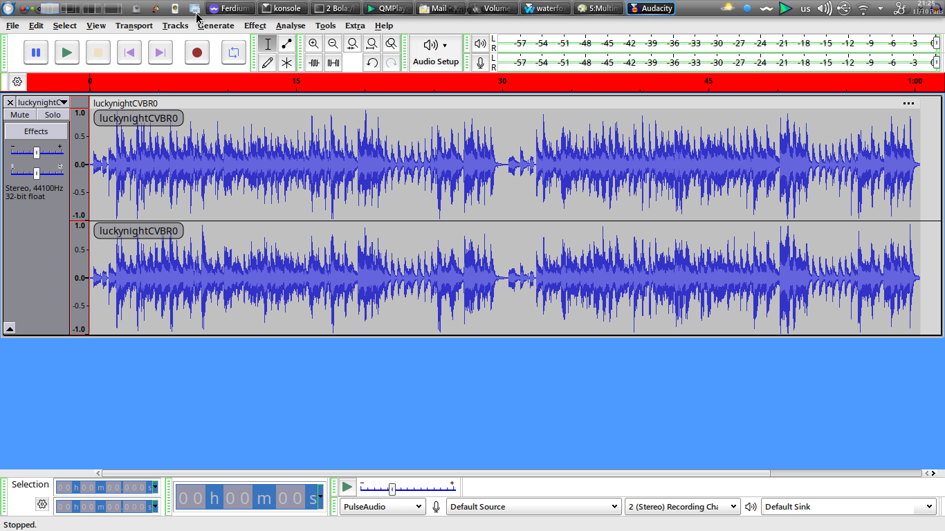

I tried an 3.6.0 alpha before 3.5.1 (again, I have my reasons), but the builtin theme there looked almost as bad as the upper screenshot, except I got yellow as the background colour in a number of widgets instead of green or red, and the volume sliders were black rectangles unless I hovered the mouse over them.

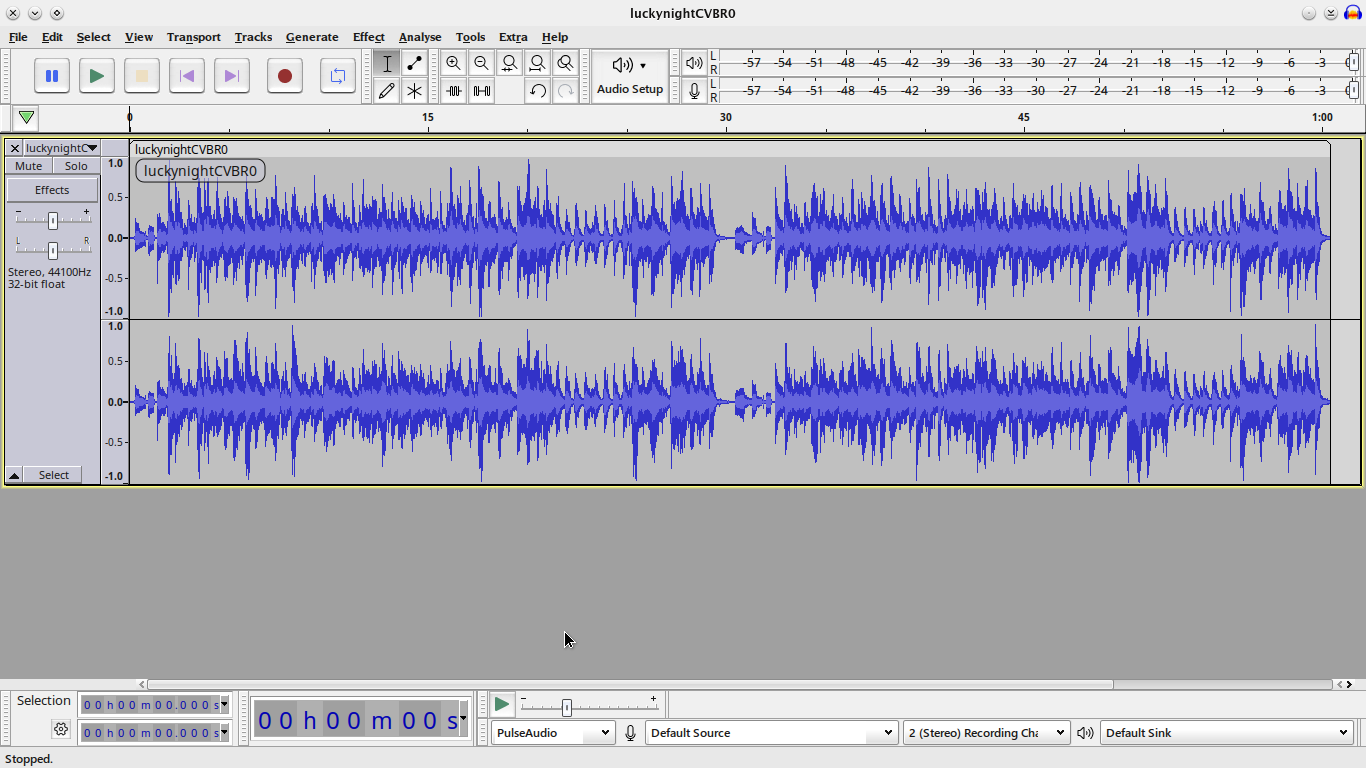

For reference, here’s how the classic theme looks in the 3.4.0 alpha build that I’ve been using until now:
Now that’s what I consider a “pro” colour palette… (I also managed not to get the DE top panel thingy in the screenshot this time).
