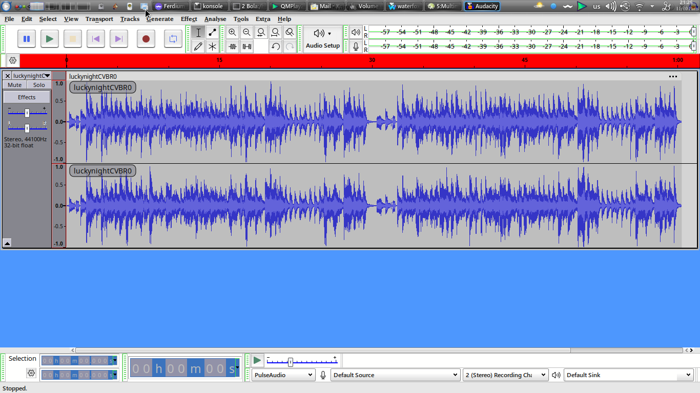

I’ve been using a 3.4.0 alpha build (3.3.3_748 according to the git tags) that is about as perfect as it probably can get in the looks department to my eyes. I’ve started to upgrade, in steps because I do have a small collection of personal patches so just based on the source tree layout I decided to check out 3.5.1 first (actually 2 commits after the 3.5.1 release). Something has changed in that release, probably in the theming implementation, causing me to get red and green colours in places where this can’t be intended; see the screenshots here: Where is the download link for this classic theme? - #4 by RJVB .
Question is, is this because I should move to the GTk3 wx engine or because of some (indirect) dependency that is too old but not caught by the build process?

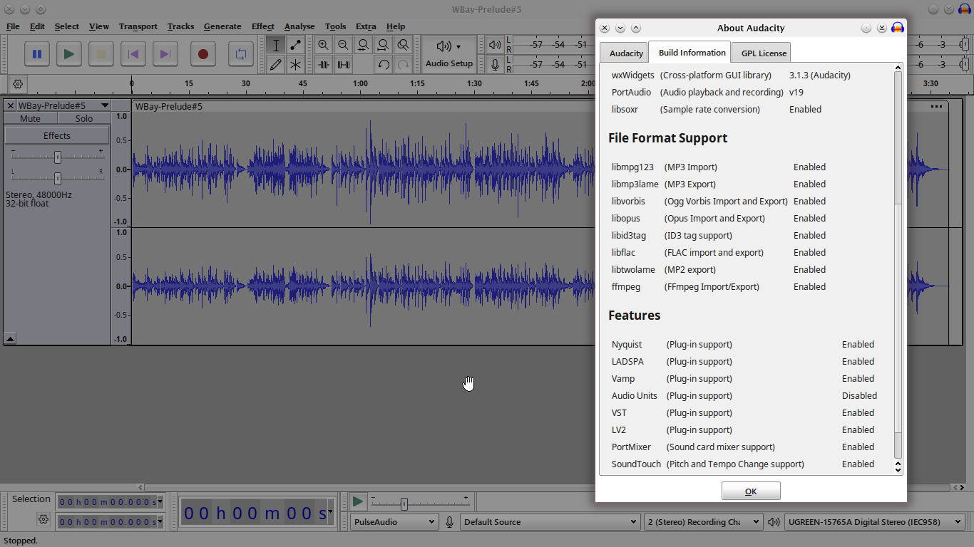

Side-note: in fact, according to BUILDING.md it should be impossible to use a system PortAudio, and I remember that this was the case at some point. It hasn’t true for a while, except that the version I now have (“09b77314a48da8b0b48dacd91c6850a3f926c42f”, aka 19.8) comes with cmake modules that define a “PortAudio::PortAudio” alias so I have to patch Audacity’s FindPortAudio.cmake because apparently these things are case-sensitive.
For completeness sake, this is the look I get in 3.5.1 :

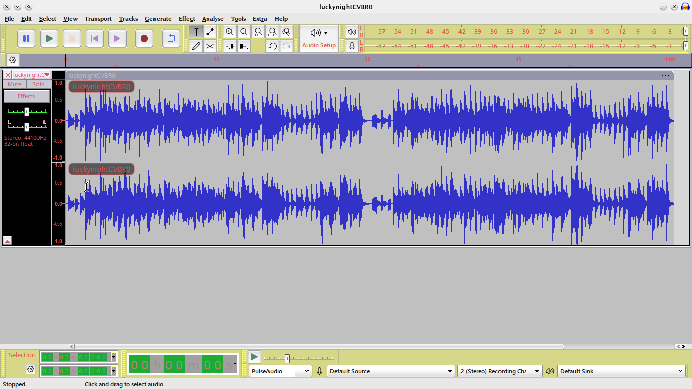

When I revert #96aac54a94e1bd4d3cd18c3803e753ed3953ee31 (make colorways[??] themeable) I get rid of the red background and the green highlights, but I gain some sort of khaki background for the top and bottom toolbars, and it’s the text that becomes red, plus some other changes that must be quite obvious :

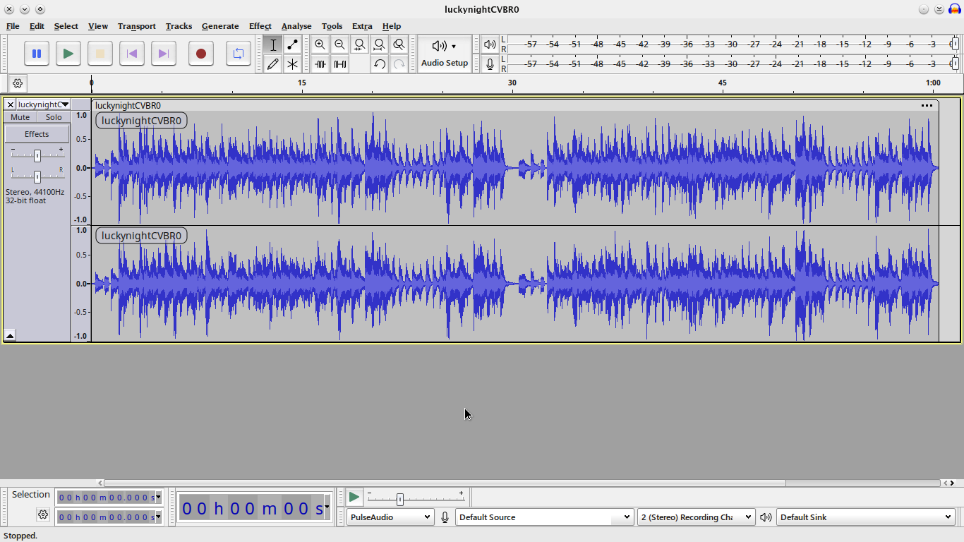

I then restored this change, and reverted #b78dcf3cb90cc95f2ea50892b88a39647d35b521, reintroducing theme blending. I had high hopes, and for once they were confirmed:
I honestly don’t know why that feature was removed; maybe it could be brought back as an option because apparently Audacity becomes upset by some of the colours I have in my system palette?!
EDIT: I marked this as a solution, but somewhere between #0ffa73b9f44acc339e12a350edadd96590dc4b17 (where it works) and #2677399f41473fd1cd13f607018475741350c0e1 more changes have been made to the source that cause a completely black background in the toolbar panels :frowning:
EDIT2: one of the reasons why things can go wrong is that the build process executes image-compiler without ensuring that it uses the libraries it depends on from the current build directory rather than from whatever Audacity version is installed.
