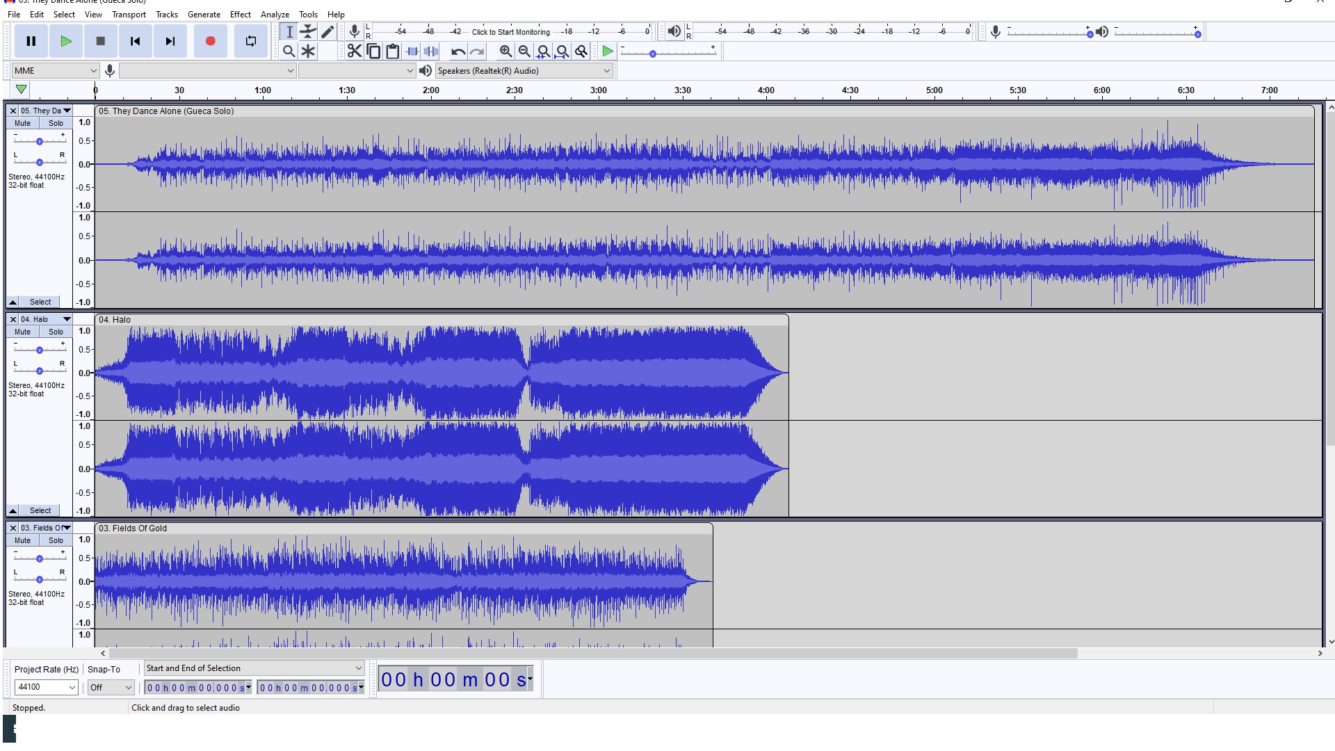

Actually after closer inspection the 7.16 might be after 0, if that is the case how do make them all start at 0? As when I rip a cd using EZCD, I have it set to delete silence from the beginning and end, so I would have thought all would start at 0.
Here’s the screenshot you asked for
That certainly looks like the first track should export as around 7:30, the second track a bit over 4 mins, and the third track around 3:40.
If they are all exporting as 7 mins something, try importing the files back into Audacity to see what they look like.
Yes, after I import back into Audacity they are all the same length
