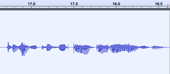

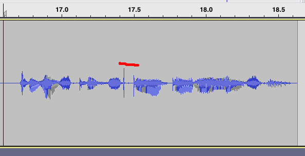

I can show them to you. There’s two serious ones just before 17-1/2 seconds. The second picture is the blue spikes reduced (and the tick sound suppressed) with DeCrisper1.
I can barely hear them, but I know the eagle-ears on the forum are going to be right on this.
See the blue blob just after 18.3 seconds? It’s very much smaller in the bottom clip. That’s “Goddaughter LeSSSlie.”

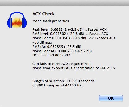

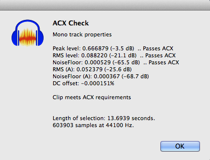

Use 9.
As near as I can tell, the step up to 10 causes problems, but 9 setting seems to be the sweet spot.
This is 9 Mastered but no Noise Reduction
And this is 9 mastered with gentle 666 noise reduction. First three readings and sentence 2/3 down.
So that will pass ACX technical standards and I’d be shocked if they didn’t love your voice.
