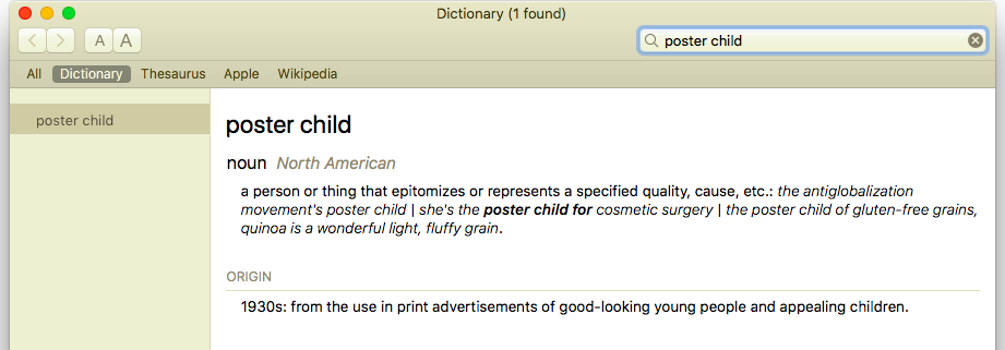

Why should I be a poster child? Is this some kind of new concept?
I dusted off a 10" laptop I’d given up on as being too slow and with too small a screen to be useful for recording. I listened to it. No noise. I will run tests and prove for myself which method will produce better recording. A Snowball with a silent laptop, or a Zoom h2n with no machine in the room at all.
What I want to be a poster child for is producing an audio book people will actually listen to. During my lifetime.

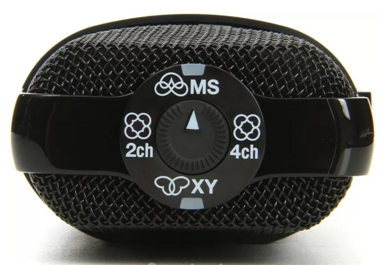

There is one question I don’t know. The microphones inside the H2n are not always stereo Left and Right. Sometimes, they’re Mid-Side and I don’t know the best way to get from that to a single blue wave mono show. Which selection on the top does your machine come with?

Do the test as X-Y. Then, when the test arrives in Stereo (two blue waves) Tracks > Mix > Mix Stereo Down to Mono. That should give you a single blue wave with a mix of the best features of the microphones.

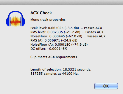

Okay, poster child here, back again. I got through the zoom manual, shut myself up in my closet, the one with egg crate foam hanging from the ceiling, and recorded a sample. Also just recorded some room noise.
That went OK. There’s still a tiny bit of motor noise in there. I wonder if it’s coming up through the floor. Anyway, It easy to suppress now.
There’s two versions for you to listen to. The first one is plain mastering and very gentle noise reduction.
The second one is a little magic. I made a filter called DeCrisper1. It takes a little of the harshness and lip smacks out in addition to the other tools.
See which you like. Listen for overly crisp SS sounds and your two lip smacks just after 17 seconds. DeCrisper1 should reduce them enough so you won’t have to mess with special filters or effects, or worse, patch them by hand. Only the second clip has DeCrisper added.
I do have a complaint. Yes you recorded nice pure room tone, but you were also supposed to record it at the front of the sound clip. ACX Check analysis tools try to measure noise in the performance, not as a separate file. So before I did anything else, I took out the noise you made just before speaking and put two seconds of clean room tone in there from the noise track.
See which version you like.
