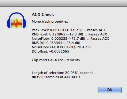

We publish ACX Check which will tell you, most times, how well you’re matching the three ACX sound specifications.
It is possible to fake it out because it needs at least 3/4 second of background sound—Room Tone—to measure noise. If you never stopped talking long enough for it to work, it will give a stupid-high noise measurement.
It’s usually so far off that There Must Be Something Wrong and nobody takes the numbers seriously.
You can get bad readings the other way, too. Nobody can record a work with a -89dB noise (for example). It’s too quiet. To get a measurement like that, you had to artificially mess with the sound. ACX hates that.
https://wiki.audacityteam.org/wiki/Nyquist_Analyze_Plug-ins#ACX_Check
That tool is where this picture came from.
