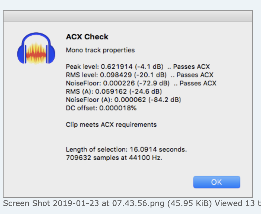

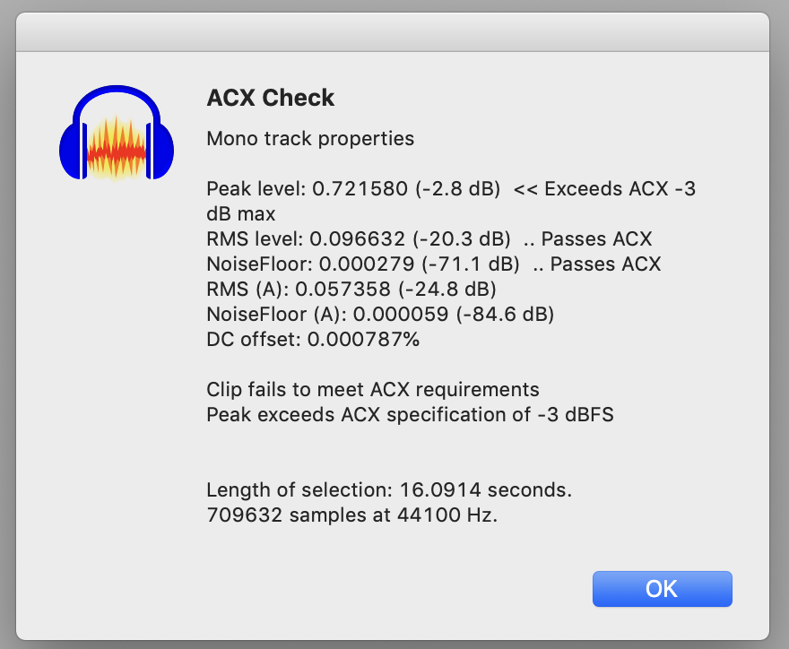

Thank you Kos! I managed to get it installed. I gave ACX Check a try with the “The Cat” file you checked but with a different result.
Is there a reason why my test failed? Maybe I did something different/wrong. Sorry the pics are so big.
The specifications for raw reading and the ones for finished submission are different on purpose. Raw reading has to take into account the possibility of high voice volume and overload damage (very, very bad) and so the specification is quieter than the book submission. Live Reading Audio Peaks (tips of blue waves) should occasionally reach up to about 50% which is about -6dB on the bouncing sound meter.
That’s quieter than ACX submission standards which are pretty strict. So you can only use ACX Check after you master. You can’t announce straight into an audiobook. Or you might do that once by accident, but not reliably for all the chapters in a book.
-Mastering-
Equalizer to get rid of rumble and microphone errors, RMS Normalize to set loudness and Limiter to take care of blue wave errors. As it says in the instructions, if you have a quiet room and know how to read out loud, that may be all you need.
Your readings are slightly hotter or higher volume than is probably good. See where your peaks are at -2.8dB (first reading). Those should hover around -6dB or so (quieter). With peaks that high, you can’t have excitement or “yell” as part of the show. The sound track will overload and distort.
So run it a bit quieter and then let Mastering make up the difference between what you shot and what they want.
If you do need to yell as part of the show, there are pro techniques where you back away a little or yell off center so the microphone gets the stress in your voice without the sudden high volume.
This is The Cat mastered. It sounds exactly like you, but this time it fits in the ACX specifications.
