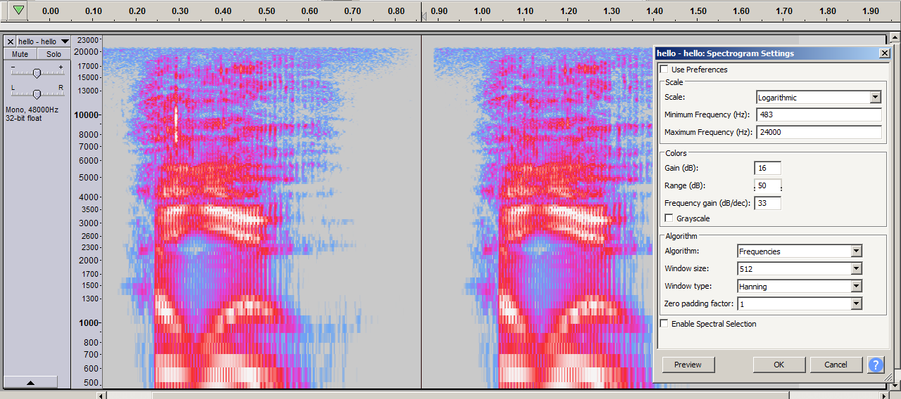

I do hear some of the odd background noises and they’re messing up the measurement tools.
We had one poster who had a squeaky chair and he rocked back and forth nervously as he spoke. We allowed maybe he should stop doing that.
The click on “hello” is in the 6kHz -10kHz range.
So if your speakers / headphones / ears don’t operate well in that region you’ll have difficulty hearing it.
It sticks out like a sore-thumb on the spectrogram
