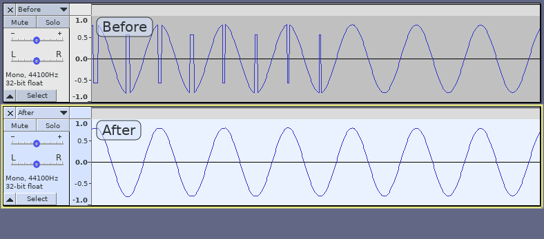

Basically what the “ESP-ClipFix.ny” does differently from the shipped version, is that it does two passes.
The first pass looks for inverted peaks, and replaces the inverted audio with a flat top to the peak, like this:
This is the code that does that (updated for current versions of Audacity).

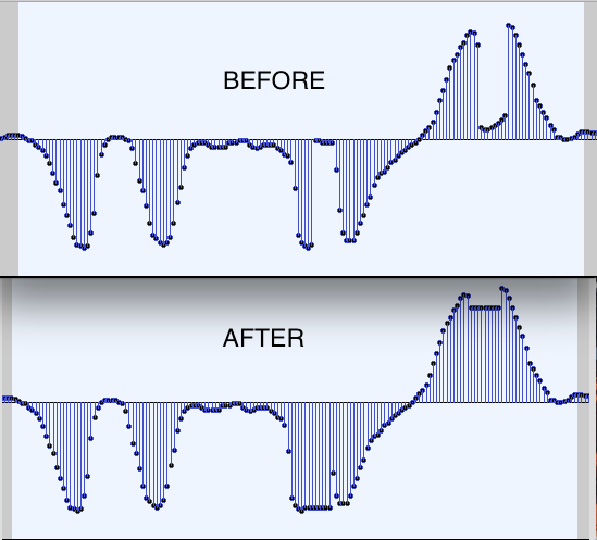

It works pretty well…

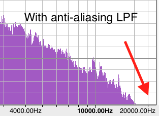

I discovered that under certain circumstances, applying the plugin, created some frequencies very close to the Nyquist frequency
(half of the sample rate), which can cause aliasing.
This can be very clearly seen below:
To reduce the possibility of aliasing, version 2 of the plugin, includes a 6 pole low pass filter set at sample freq divided by 2.1.
So at 44.1 KHz, the plugin will filter the top end from 21 KHz and at 48 KHz, it will be just under 23 KHz.
The result, is a much cleaner top end:
The original download link for the plugin has been updated with version 2.

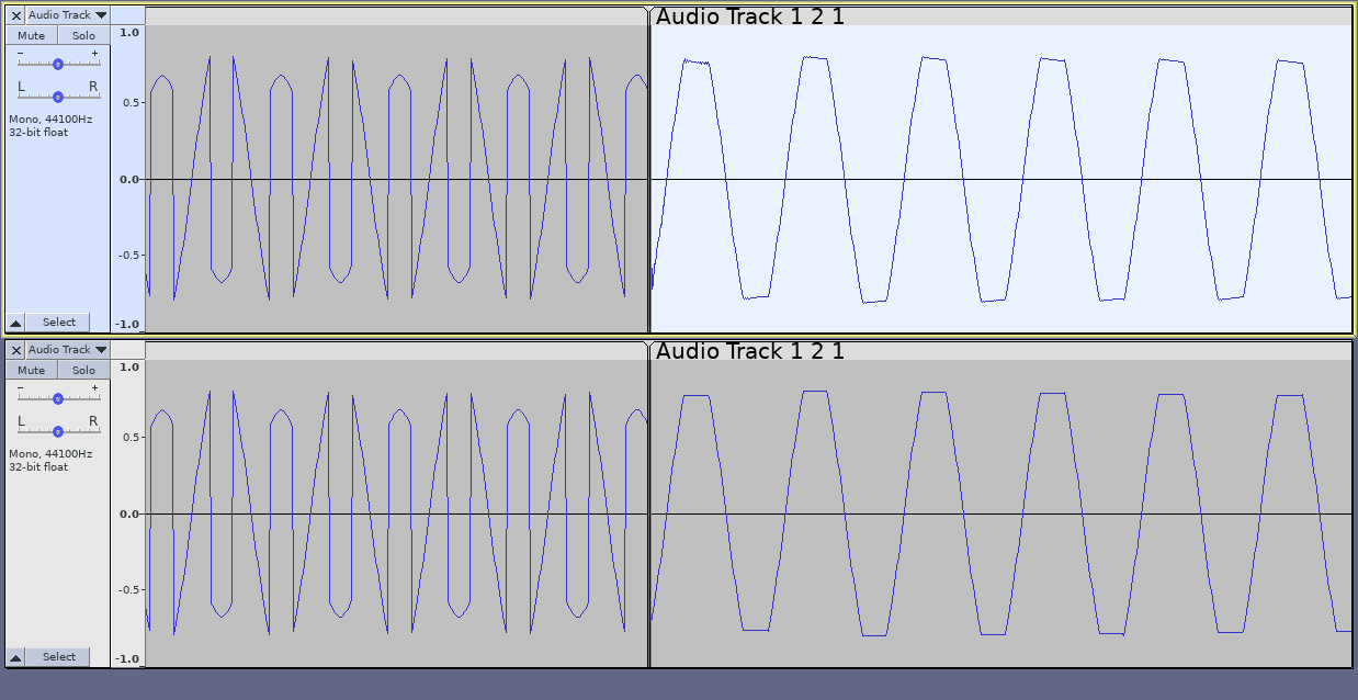

As a standalone effect, there’s no problem adding the filters to the code, but if used as originally intended (as pre-processing before applying ClipFix), the filters change the shape of the peaks, causing ClipFix to be less effective.
In this screenshot, both tracks started with the same audio with inverted peaks (the unprocessed sound shown on the left).
The right side of upper track was processed with your new code.
The right side of the lower track was processed with the code that I posted.
Observe that the tops of peaks processed by your code are sloping:
And this is after applying ClipFix with default settings:
