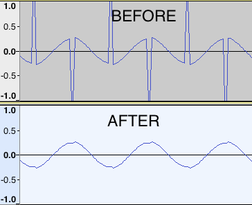

here is a plugin normally meant to fix inverted peaks in audio recordings, which can then be subsequently
processed with another plugin that ships with Audacity, called Clipfix.
The plugin is mostly based on Steve’s Updated Clipfix plugin. I added a slider to allow the tuning
of the max sample level difference, and a DC removal filter plus an antialiasing filter.
They can both (or individually) be de-activated, which is recommended for “normal” use.
Normal use:
The plugin would be used on audio that has inverted peaks due to clipping/crushing.
The single control slider (“Sample Max Delta”) can be left at the default of 0.5 for most applications.
For extreme cases, it may be worthwhile experimenting with different settings.
Best to de-activate both filters.
