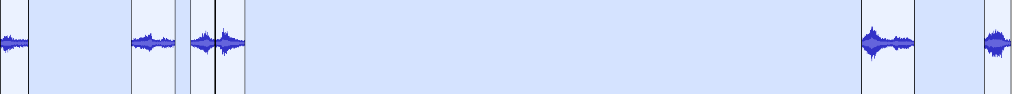

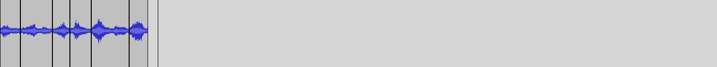

This is a common situation. The user isolated clips that are interesting and wants to push them together so they can work with them on a compact space and decide whether to export them individually or together in one and maybe perform fades.
From this:
To this:
Manually achieving this involves very unsatisfactory dragging with insecurity whether they are a snug fit or use of a lot of cut paste and jumping to the end.

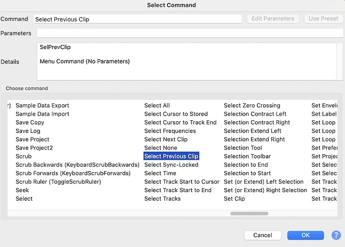

I tried to make the macro, but it didn’t go so well.
First, I looked for somewhere to paste your code text – didn’t find, so I started using the Select Command dialog.
But then I got stuck because I couldn’t find the 2nd command “SelPrevClipBoundaryToCursor:” – see my 1st screenshot. I’m aware that you can set parameters with some in that list, but as you can see there’s no option for that with the one I selected – and nothing nearby looked promising.

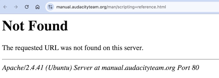

So the next thing I did was push the help button at the lower right and this is the page I got:
