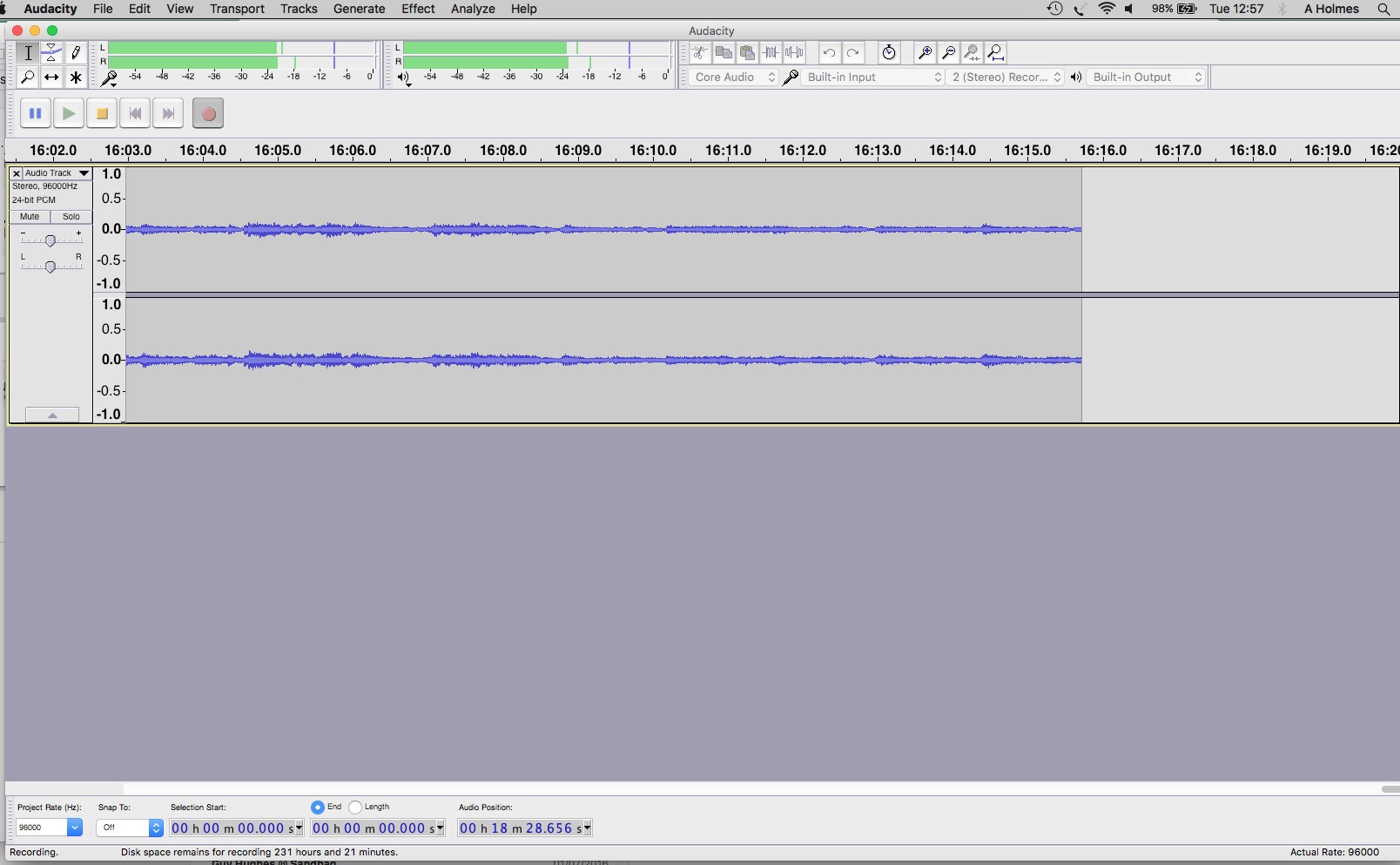

I’ve linked a toslink cable from the optical output of my Linn Akurate DSM directly into the built-in input of my late 2011 MacBook Pro to digitize some vinyl albums that aren’t available on CD. The vinyl is played on a Linn LP12 into the Akurate DSM.
The MacBook Pro is running El Capitan 10.11.6 and Audacity is 2.1.2 build date 12 Jan 2016 commit id 53b8fd5.
Sometimes the recording ‘skips’ a few seconds randomly. It’s definitely NOT the vinyl; I monitored the recordings and the music sounded fine.
e.g.
An album I tried earlier today plays back on Audacity (before any editing etc.) fine for about 2 mins then I hear a 1-2 sec ‘skip’. This randomly repeats. So at the end of that side of the album the Audio Position at the bottom of the screen correctly shows 27m 41 secs BUT the graph showing the wave across the screen ends at 25m 29s. So with various random ‘skips’ over 2 mins has been lost over the album side.
I’ve attached a screen grab during the recording which already shows a mis-match between the Audio Position (correct) and the time on the wave graph (wrong).
I am totally lost as to what might be causing this. Other than the ‘skips’ the recording sounds great.
Any ideas?!?!?
See if there’s anything in here.
http://manual.audacityteam.org/man/faq_recording_troubleshooting.html#pauses
Keep reading even if it seems the document is going off on the wrong direction.
Also try this http://alphamanual.audacityteam.org/man/FAQ:Recording_-_Troubleshooting#mac_crackle
but note that is our work-in-progress Manual for the next release of Audacity, so don’t otherwise use that as your help document.
