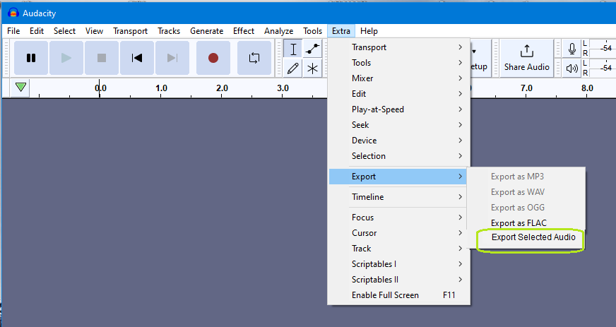

@LWinterberg Leo, maybe you could give them an Export Selected Audio command in one of the Extra menus?
That way they could create a custom shortcut for it for ease of use.
Peter

@StuartGauffi @JeanDaspry and @LWinterberg
I have raised an enhancement request for this on GitHub.
Add an “Export Selected Audio” to the Extra>Export menu #5581
