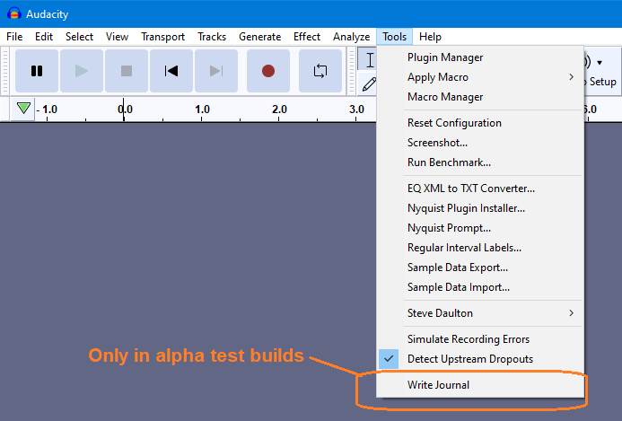

Do you know if the journal was human readable or usable in any way for Audacity users? I tried looking at it in an older alpha version, but it just crashed, so I was unable to find out exactly what it was supposed to be.
Hey, thanks - I don’t have this under Tools on 3.2.2…
