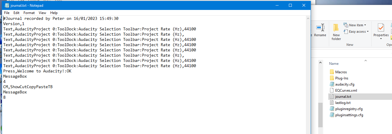

I do get a jounal txt file in the Audacity settings folder:
That was just importing an audio file and adding the cut.copy/paste toolbar - I got a journalling error when I tried recording
