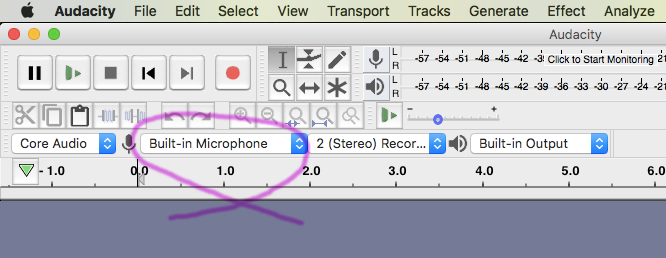

P.S. Attached is a screenshot of the current settings.
Look at the Recording Device setting in the Device Toolbar in your screen shot - it is set to “Built-in Microphone”. Change it to “USB Audio CODEC” and you should get a recording. If “USB Audio CODEC” is not available, click on the Transport menu select Rescan Audio Devices.

Recording device should be USB thingy , not “built-in microphone” …
I can’t change it change the setting to “USB Audio CODEC”. For some reason, I can’t seem to change the setting for Recording Device in that toolbar. When I highlight it with my mouse, it won’t give any other option to select. The software runs fine otherwise.

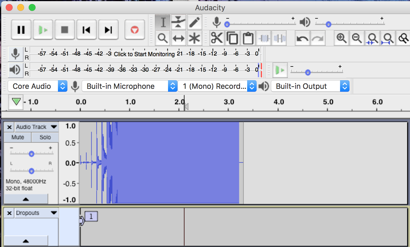

No - the meter doesn’t move, and now when I try to record it seems to go into a scary robot feedback loop. And it is not giving me any choice other then Built in microphone - I went through the steps and it is selected in System Preferences. See attached screen shot. Also in system preferences the USB device seems to be flashing on and off. Bad cable maybe? Ug, I’m ready to give up…
If the sound input meter in System Preferences / Sound / Input does not move when have selected the USB PnP Audio Device and you are playing a cassette in the Wikoo, then the Mac is not receiving sound from the device. If the Mac is not receiving sound from the device then Audacity won’t.
Perhaps a bad cable, or a bad connection.
