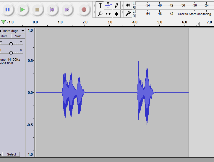

1 How to i adjust the mic sensitivity of my samson Q1 so that it picks up the sound from afar because the mic is in the room but not close to the dog s mouth and i am afraid that the bark would be missed because of the mic not grabbing the sound when it passes.
2 so far i only see a line with small dots instead of sound bleu drawing, how to make them visible? imore area under the curbe in matematic terms.
3 It is usefull for me to be able to see after how much time the barking happened and usefull to listen to it. How can I easily see the moments of barking?

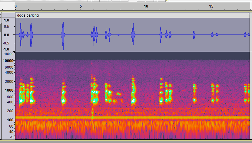

The spectrogram display is more useful than the default waveform display to differentiate dog barking from other sounds …

Also , on the nice picture you sent, the top has wave form from -0.8 to 0.8. how to do that because atm i onle see points like probable -0.1 to 0.1 ? thanks
There is a spectrum display on Audacity 2.0.5 : it has different colors,
and you can either have waveform or spectrum, but not both at the same time …
waves or spectrum

You can create a multi-view in Audacity 2 by duplicating the track, having one track display waveform, the other display spectrogram, ( you have to mute one track otherwise the volume will be twice as loud)
sort of dual display on audacity2
