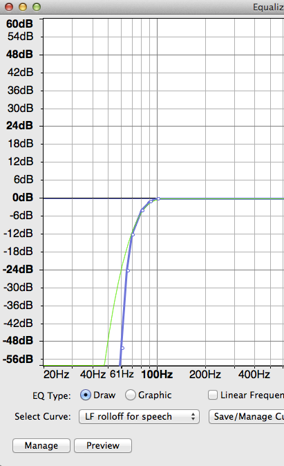

LF Rolloff is a bit of an odd duck since it’s not a stand-alone tool.
You can get it from me. Unzip it to the .ny file by clicking.
http://www.kozco.com/tech/audacity/Documents/LF_rolloff_for_speech.xml.zip
Adding Audacity Equalization Curves
– Select something on the timeline.
– Effect > Equalization > Save/Manage Curves > Import
– Select LF_rolloff_for_speech.xml > OK. (it won’t open the ZIP. You have to decompress it)
– LF rolloff for speech now appears in the equalization preset curve list.
I expect it to look like this. Click the graphic if needed. The green line is dead flat to the right.
