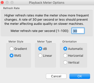

Right click on Audacity’s recording level meter and then click on settings and use
the following setting:
You will then get this:
The light red can then be used as a RMS indication and the dark red as peak.
Same applies to the playback level meter, but it’s green.
This has served me well and no need for external plugins or “virtual cables”.
