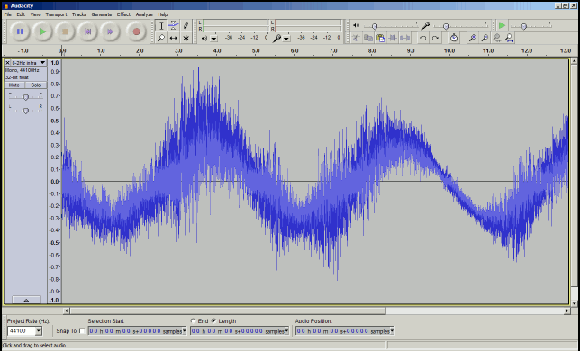

Your track has very large amounts of infrasound, this low frequency sound is not audible but distorts the waveform and causes problems when processing the waveform, (e.g. applying compression). Before you process a track apply a high-pass filter like the one shown below to remove infrasound.

If the infrasound was not removed from the vocal-only track and compression was applied, that could account for the vocal volume abnormally fluctuating : the vocal waveform is superimposed on the inaudible low-frequency infrasound waveform. If dynamic-range-compression is applied to a track with high-amplitude infrasound there will be noticeably more attenuation of the vocal where the infrasound has a peak or a trough.
The first thing you should do to any of your recordings before processing them, (e.g. applying compression), is remove the infrasound with the equalization shown below … No-infrasound-in-Audacity.xml (187 Bytes)
