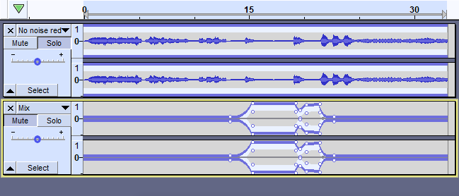

I’m trying to remove hiss from an instrumental piece following instructions posted by vpd. If I kill everything 4000hz and above, it gets most of the hiss, but in a few areas, it kills things like a higher pitched drum roll.
I went back to the original track and tried again by directly applying the same EQ settings as above without first duplicating, inverting and then merging, and I don’t hear or see any difference.
I wonder if I’m missing something in vpd’s method? I don’t understand the reason for applying an envelope with no modifications.
I’ve attached an MP3 with some snips of what I’m trying to clean. There are no hiss-only sections in the original track.
Thanks,
Chris
Well, this is an old thread (and revised over a year ago). :smiley:
So I think what vpd is trying to do here is to use the equalizer and some simple arithmetic to come up with a track that contains the “noise”, your hiss, hum, and whatever. In this case, it is inverted so that it will subtract right out of the original signal. Now, in step 7, he wants us to “auto-duck” this correction track wherever the original signal level is high, or in places where we just don’t want it removed.
In your case, I noticed the noise around 15-22 seconds, so at step 7, I manipulate the wave-forms as mirrors of yours at 15, 19. Outside of that region, I didn’t notice the noise, so I eliminated the correction completely.
I hope this helps. (And I hope I got it right!) :smiley:
