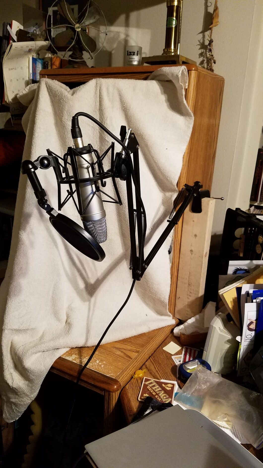

Cool. Do you have the boom microphone stand?
If you’re recording with the microphone on your table or desk, that may be where some of the noises are coming from. That zig-zag spider thing on the back of the mic prevents that, but it doesn’t prevent sound reflections from a bare desk.
Note in the picture, there’s a heavy furniture moving pad on the desk and one on the wall.
You can also inspect your environment and see if there’s anything that you can tap with a pencil and make ringing noises. Wine glasses are famous for this. You can have lampshades of glass or ceramic and they can ring. Do you have the microphone propped up on a coffee mug? Don’t do that.
If you do find a software solution, you will need to remember to apply it to every recording, forever. That’s why making a studio is important.
Thanks for your help Trebor.

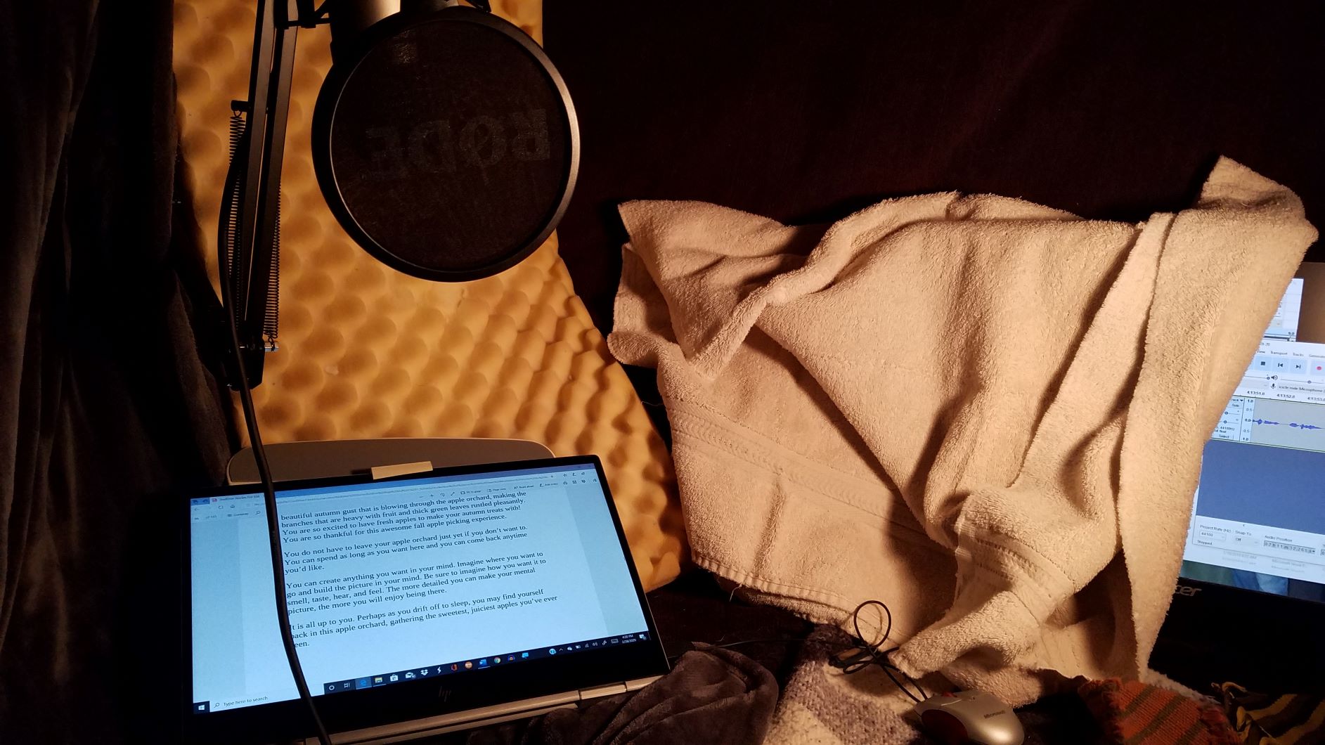

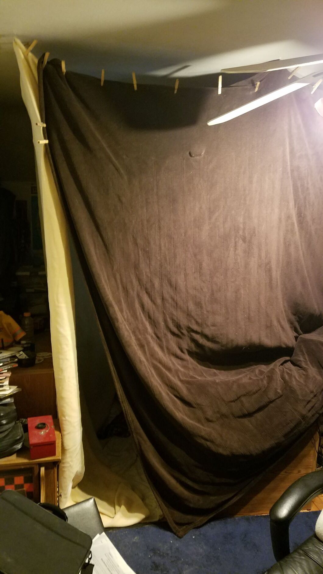

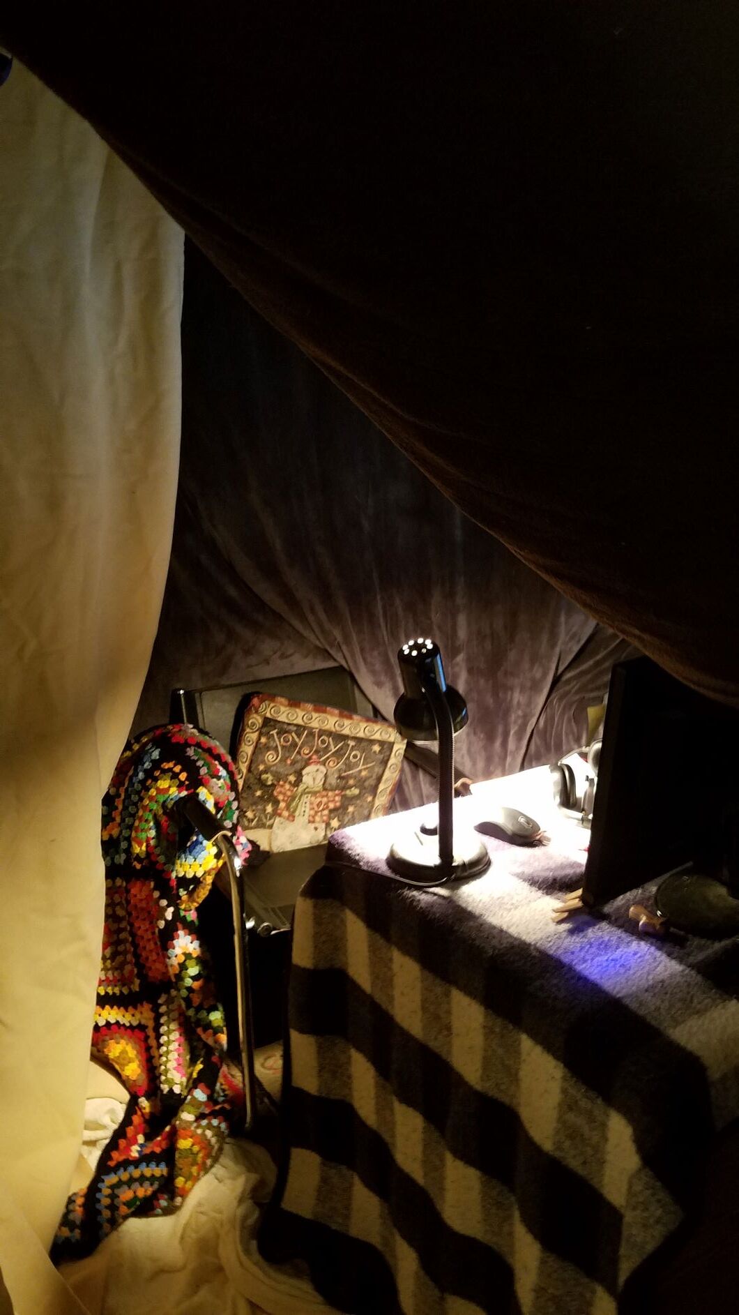

Koz, I finally have some pictures of my home setup. My mic ‘stand’ is the type that came with my original mic, a blue snowball ice [which I probably didn’t do enough research on before I bought it and didn’t care for the sound so I switched to the rode pretty quickly]. The pic with the mic stand is shown exposed and with a towel behind it just for contrast. I record on my desk top [and cover part of the screen with a towel for what I hope is some sound proofing]. Not very good pics but it is tough to inside for pictures, so the outside view is for perspective. I basically hang heavy blankets from rope on hooks attached to the ceiling.
