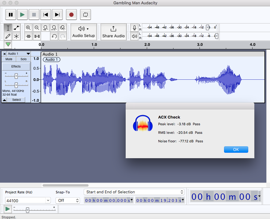

Would you say technically they are sound? Any recommendations on what I can be doing better? Appreciate the time you took in responding sir!
I think they’re fine as they are. I think you are more likely to run into oddball problems like needing to have your book for sale on Amazon before they will consider it.

One odd note. Room Tone or background noise should not be dead quiet. Yours is good at -67dB or so. Anything from there into the -70s should be OK. They don’t like submitted noise in the -80s and -90s. That usually means the poster has applied limiters, filters, and Noise Gates to the work and that can damage the sound.
This problem just kills many home readers. They’re fighting natural house and room noises, plus low volume and noisy home microphones. Everybody reaches right for the Noise Gates and other post production tools.
If you can’t walk away from a simple recording with background noise in the -60dB range or slightly better, it’s going to be a long day.
Despite what ATX-Check plug-in says,

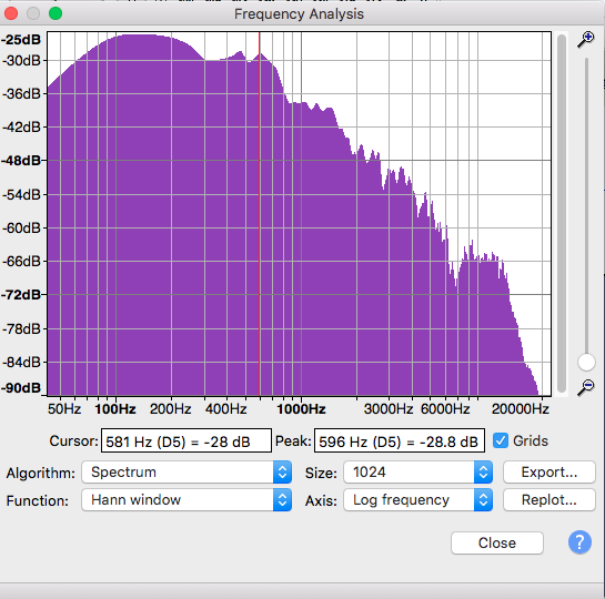

Your equalization is good, but IMO benefits from filling-in notches @ ~850Hz ~2800Hz …

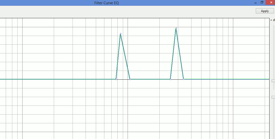

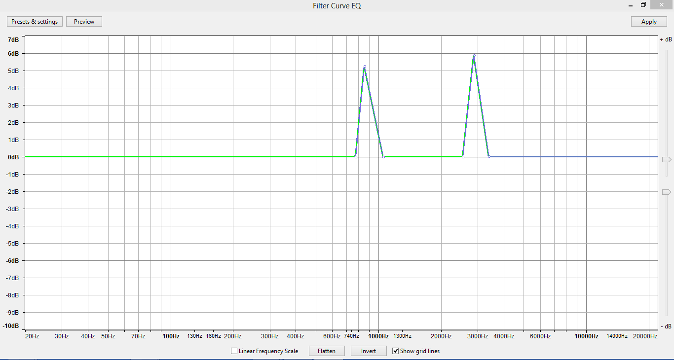

I used Audacity’s filter curve to push out the notches ,
(but there is a free AutoEQ plugin which will automagically remove such dents).
Removing the notches in the spectrum removes your room from the recording.
(the physics of the room added the notches via destructive interference).

What settings did you put into the Filter Curve to push out my notches?

At one time it was possible to share Audacity EQ curves presets, but not now :frowning: ,
we have to redraw them, in this case with millimetre accuracy.

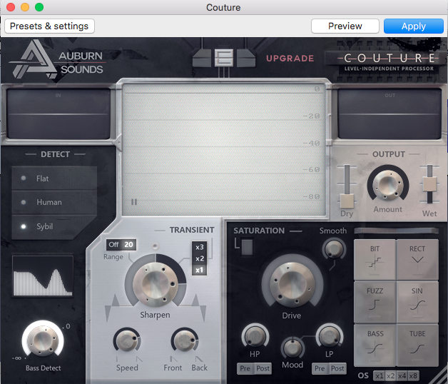

Okay Trebor, I’ve used the Couture program you’ve recommended using settings similar to what you recommended in a different post that I found on here.
I have added the peaks in the filter curve per your drawing (got it as close as I could!) I also have the low roll off for speech factory preset in there as well. So my macro is running your two custom peaks and the the low roll off for speech for filter curve. (see attachment)
I also use a de-clicker plugin and I was wondering, is it a good idea to run Couture and de-clicker BEFORE my macro or after my macro? Does it really make a difference either way?

You’ve drawn the filter correctly …

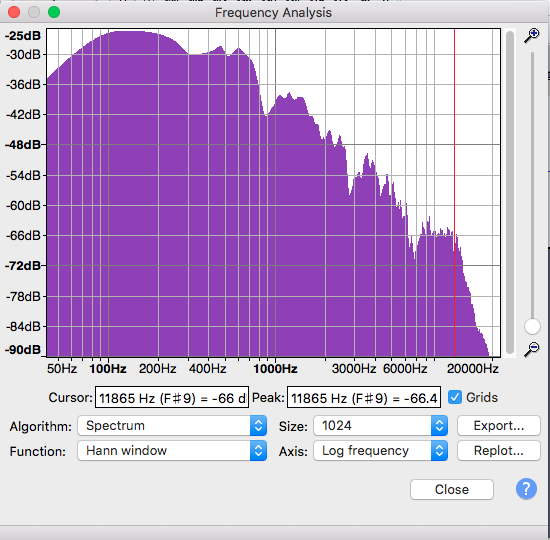

but it’s not been applied: if you look at the spectrum it still has the notches …
Looks like Couture has been applied to “Gambling Man 2”, & in a transparent way:
If I hadn’t heard the original, which has audible hiss, I would not be able to tell an expander had been used.
If you’re using a de-clicker, I would use couture after it in the effects chain,
as any clicks in the “silence” between words & sentences could cause couture to let more noise through.
I would not leave out Noise Reduction in this case,
if anything I’d be tempted to use a fraction more then 6,6,6.

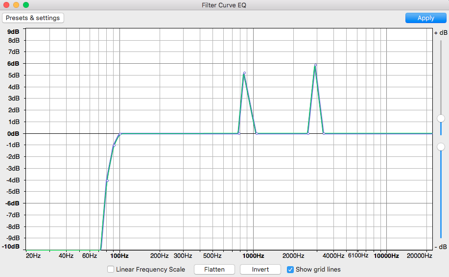

That is interesting as I’ve edited the first option in my macro ‘filter curve EQ’ according to your drawing (low roll off is still there, is that ok?)
Ok then shall the order be 1. De-clicker, 2. Couture, 3. Macro, and 4. Noise Reduction (every time)? More than 6,6,6… are we saying perhaps 9,6,6 is better?
I took the wav 2 file I just sent you completed last time and applied the EQ curver filter (just the two custom peaks, no roll off) and have pictured here below.
I wonder how come my macro didn’t apply it… perhaps the low roll off is buggering the process… hmmmmmmm. :confused:
