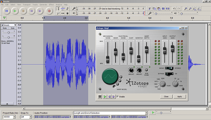

Some do though - I have iZotope Vinyl running sweetly on my W10 laptop as a plug-in in Audacity - it’s a great plug-in eanbling you to restore all that fabled vinyl “warmth” ![]()

Peter, do I need a plug-in host to enable izotope vinyl? or more specifically, now that i’ve downloaded it, how do I open it and run it? If I need a plug-in host, I’ll have to download one, can you recommend a good (free) one? Thanks.
I can testify izotope vinyl will run in Audacity on Windows …
Basically you shoiuld just bneed to go to ythe Plug-in Mananger in Audacity (use “Add/Remove Plug-ins” the top menu item in the Effect menu). lokk at the “New” items, and enable iZotype Vinyl - and don’t forhet then to click the OK in the dialog.
See: Plugin Manager - Add / Remove Effects, Generators and Analyzers - Audacity Manual
Like Trebor have iZotype Vinyl installed on my PC (downloaded using the installer on the iZotop site) and activated on Aufa=dacity as above - and it runs fine.
