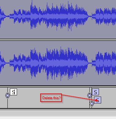

I like to use “Silence Finder” to divide my recordings and set label locations. Sometimes that takes a lot of tweaking of the parameters and still I might get 1 or 2 “extra” labels generated in the silent sections or in a pause in the ongoing track. I can’t seem to find a way to just delete the extraneous label. Can someone help?

Firstly, I’m currently working on “Silence Finder” to try and make it more accurate at detecting sounds/silences with less extraneous labels. Progress is good so far, but it will still take a while to complete the work.
Secondly, to delete a label, click at the end of the text in the label, then use the backspace key to delete the text. When you have deleted all of the text characters, one more backspace will delete the label.

The other cute trick you can use to delete a label or group of labels (but perhaps not useful in this case as the extraneous labels are clumped with a label that is required) is to select over the labels with click and drag, just in the label track and NOT in the audio track - then use the keyboard shortcut Ctrl+Alt+K
I use this a lot - and find it extremely useful.
See this page in the Audacity Manual: http://manual.audacityteam.org/o/man/label_tracks.html#remove
