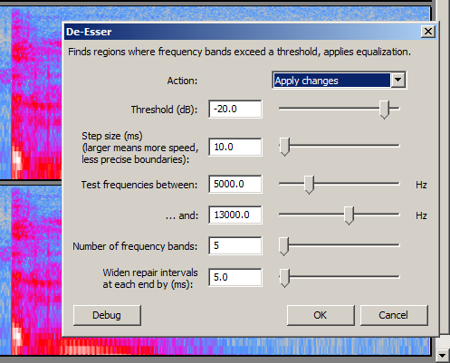

I’m on Windows , not Mac, but I believe that Paul-L’s de-esser plugin , will work cross-platform on Audacity …
I believe you’re right. At least I get the expected control panel under OS-X.
And now [drum roll] how did you determine those values? And what are they? I can’t read the graphic.

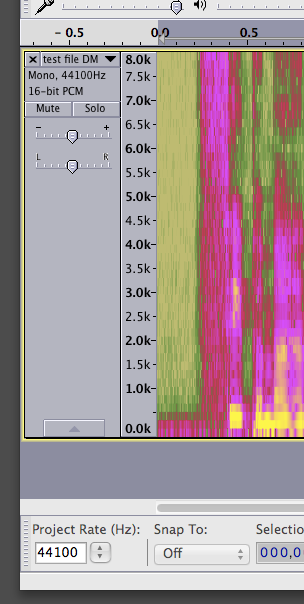

I know you’re going to tell me to get some of them them from the Spectrum View. My Spectrum View (default, since I’ve never used it before) looks like attached.

Text is readable on this version …
''For a popsicle'' before-after DeEss with Paul-L's plugin - (actual size).png
The frequency range [ 5KHz -13kHz ] I got from the white-hot “sicle” part of the spectrogram.
The threshold is by trial & error . -20dB threshold may reduce the sibilance too much, try -19dB , -18dB etc.
Use the least number of frequency bands to have the desired effect , as more bands means longer processing time.
[ Annoyingly after adjusting frequency band setting , the threshold has to be readjusted ].

But you didn’t do it with the default spectrogram, because that looks like mine.

I’ve chosen the logarithmic frequency scale on spectrogram [ “log(f)”], yours is on linear scale.
The inverted colours on your spectrogram indicate the spectrum-editing-tool is activated …

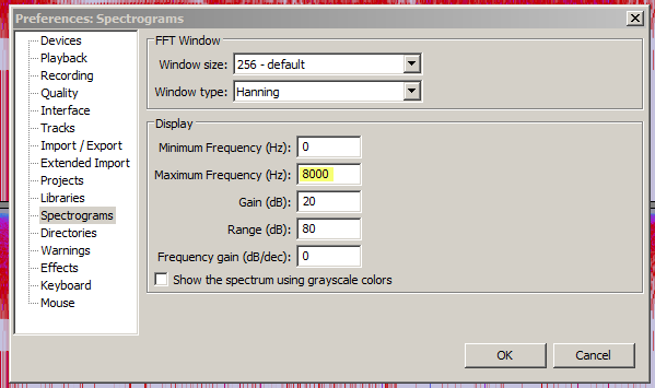

Still. How did you get a 13KHz value from a spectrogram that stops at 8. All the spectrograms on the info page stop at 8.
I must have zoomed-out* on the frequency-scale to show the full frequency range,
because the maximum frequency on my spectrogram preferences is still on 8000Hz …
[ * On Windows that’s achieved by putting the cursor on the spectrogram frequency scale, where it becomes a magnifying-glass icon, then click on right mouse-button , full audio spectrum is then shown ]

If you keep the number of bands low [ <6 ] then Paul’s De-Esser reasonably quick.
On my 5 year old computer, using 3 bands, the processing-time to DeEss is ~1/10th of the playback-time.
[ SpitFish does it in ~1/20th of the playback-time ].
