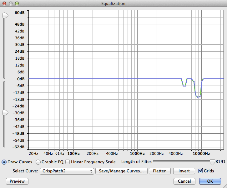

It had an Essing problem which I cured with simple equalization.
Attach 1: Overly Crisp Clip.
Attach 2: Custom Equalization curve applied.
Attach 3: Actual xml curve.
Attach 4: Graphic of the filter.
All I did was run Analyze > Plot Spectrum and made note of the two high frequency haystacks clearly in the wrong place. In addition to being easier on the ears, the shoot-to-the-moon sharp peaks in the blue waves vanished making it a lot easier to hit ACX and all without making the voice muffled.
I tried going back with the original clip to the DeEsser tool and eventually got it to suppress one (1) overly sharp Ess sound.
CrispPatch2.xml (664 Bytes)

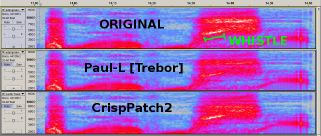

Using my suggested defaults for Paul-L’s De-Esser , processing time is ~1/20th the playback time , ( on my 5+ year old computer ) . Using your “CrispPatch2” equalization-curve , processing time is ~1/30th the playback time, so it is faster, but IMO the De-Esser does a better job at reducing excessive sibilance …
