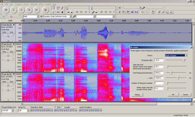

I’m on Windows , not Mac, but I believe that Paul-L’s de-esser plugin , will work cross-platform on Audacity …
I believe you’re right. At least I get the expected control panel under OS-X.
And now [drum roll] how did you determine those values? And what are they? I can’t read the graphic.

Text is readable on this version …
''For a popsicle'' before-after DeEss with Paul-L's plugin - (actual size).png
The frequency range [ 5KHz -13kHz ] I got from the white-hot “sicle” part of the spectrogram.
The threshold is by trial & error . -20dB threshold may reduce the sibilance too much, try -19dB , -18dB etc.
Use the least number of frequency bands to have the desired effect , as more bands means longer processing time.
[ Annoyingly after adjusting frequency band setting , the threshold has to be readjusted ].
I got from the white-hot part of the spectrogram.

I’ve chosen the logarithmic frequency scale on spectrogram [ “log(f)”], yours is on linear scale.
The inverted colours on your spectrogram indicate the spectrum-editing-tool is activated …

Still. How did you get a 13KHz value from a spectrogram that stops at 8. All the spectrograms on the info page stop at 8.
I must have zoomed-out* on the frequency-scale to show the full frequency range,
because the maximum frequency on my spectrogram preferences is still on 8000Hz …
[ * On Windows that’s achieved by putting the cursor on the spectrogram frequency scale, where it becomes a magnifying-glass icon, then click on right mouse-button , full audio spectrum is then shown ]

If you keep the number of bands low [ <6 ] then Paul’s De-Esser reasonably quick.
On my 5 year old computer, using 3 bands, the processing-time to DeEss is ~1/10th of the playback-time.
[ SpitFish does it in ~1/20th of the playback-time ].
