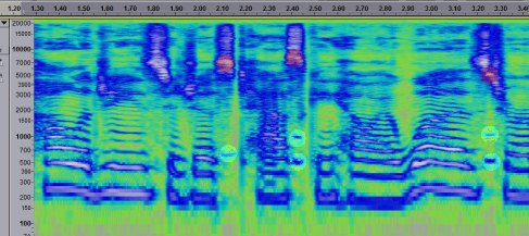

I wouldn’t even really mind this, because it seems to be concentrated in areas throughout the file…but the sounds are pretty hard to identify in the spectrogram. Some I can spot immediately…others seem fully blended in and aren’t on the same frequency range, unfortunately. So it looks like I’ve got about 4 hours of rerecording to do. That’ll teach me to do large bits of recording without listening back closely. :angry:

The artifact seems to correlate with strong sibilance …
if that’s the case it rules-out interference from other electrical devices as the cause.

It looks like the “clarinet” artifact frequency is ~1/10th the frequency of the sibilance corresponding with it …
If that was the case, the problem is occurring continuously, but only becomes conspicuous when loud high-frequency sound occurs. ( 1/10th of 200Hz is 20Hz which is inaudible , 1/10th of 7000Hz is 700Hz which is audible ).
