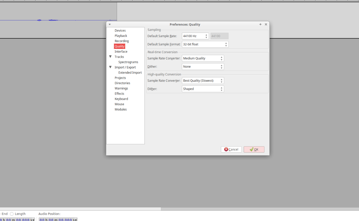

That’s Audacity’s default setting of 44.1kHz.

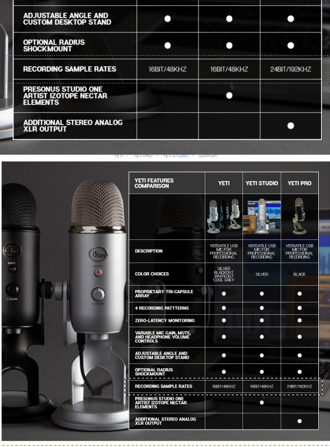

It looks like the Yeti mics either run at 48kHz or 192kHz for the Pro version, (the latter only comes in black) …
Does it still do it exactly the same way using 48000 sampling?
