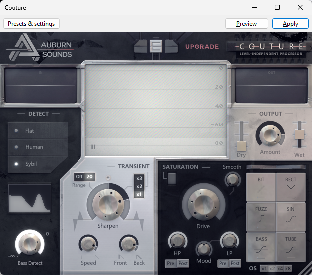

That’s it: old Couture = new Couture with “Dry” slider on -∞ (minus infinity).
The red line is the output level, here being pushed down by 6/7/8dB between words & sentences.
Couture will reduce the noise-floor, including room reverb*****, when you are not speaking.
IMO about 9db is the most you can get away with without it sounding choppy/gated.
[***** With your “Needle Park” setup I don’t think you need a DeReverb plugin, just TDR Nova with RobDo-2 settings to reduce the boxiness, and optionally Couture to reduce noise & any slight reverb].

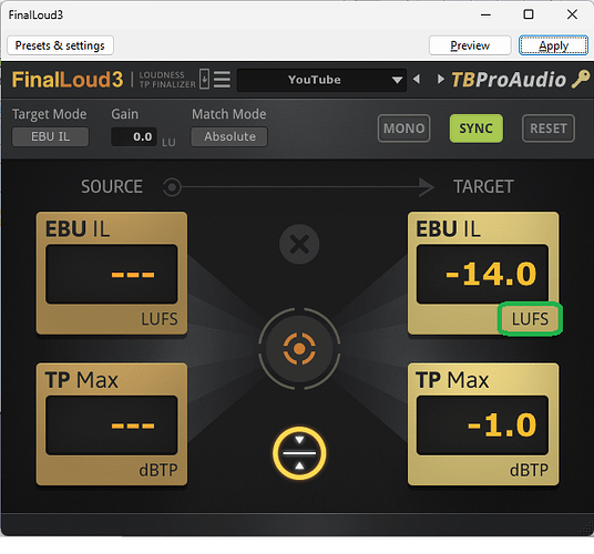

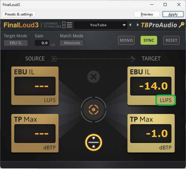

Examples of where I got the idea that you should target LUFS:
There’s a recommendations table, when you scroll down a bit, specifically for YouTube.
I use FinalLoud3 (plugin), here’s a screenshot:
They generally suggest to target -14.0 LUFS; or roughly between -13.0 to -15.0.
I know that YouTube Help doesn’t say anything AFAIK about LUFS (via Google search).
I could very well be wrong - I’m the polar opposite of an audio engineer - but I haven’t come across anything that says you should target RMS over LUFS; though I initial targetted RMS following Josh Meyer’s course on EQ and such.

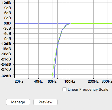

We should know that unless they changed it, all you have to do is use a tool once and the settings and adjustments “stick.” So the first time you need to be critical as to settings, from that point on, assuming you don’t change anything, it’s just Effect> Tool > OK.
I think I asked you way up the message thread if you had Effect > Filter Curve EQ > Manage > Factory Presets > Low Rolloff For Speech. That’s the custom rumble filter.
If you do, then the first time, it’s Select the work. Effect > Filter Curve EQ > Manage > Factory Presets > Low Rolloff For Speech > OK.
But the second time, it’s Select the work. Effect > Filter Curve EQ > OK. Take a quick peek and make sure you have that swooping down to the left curve.

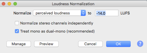

Similarly, the first time it’s Select the work > Effect > Loudness Normalization > Normalize > Perceived Loudness > to -14dB LUFS. Treat Mono as Dual Mono> OK.
The second pass, it’s Select the work. Effect > Loudness Normalization > OK.

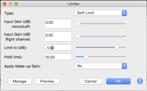

Select the work. Effect > Limiter, > Type Soft > Limit -1.5dB > Hold 10 msec. Make Up Gain, No > OK
And the second time it’s Select the work > Effect > Limiter > OK.
Please note that the limiter has been set for 1.5 rather than 1.0. I do that with other limiters to avoid creeping errors. You can have tiny errors when you post the work on-line. Your 1.0 setting can turn into 0.999 by accident which can trigger alarms. The 1.5 setting is not audible and also not likely to fail.
