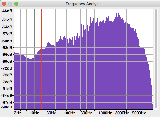

This is what the Filter Curve curve looks like when you get the right one.
It actually goes down to the left more than that, but that was the handy pix.

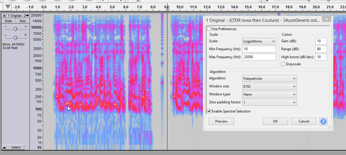

I can understand every word, but IMO there is too much bass: a resonance @ ~130Hz,
and despite the booth, some reverberation from the room.
With EQ and compression/expansion it’s possible to cut bassiness & reverberation …

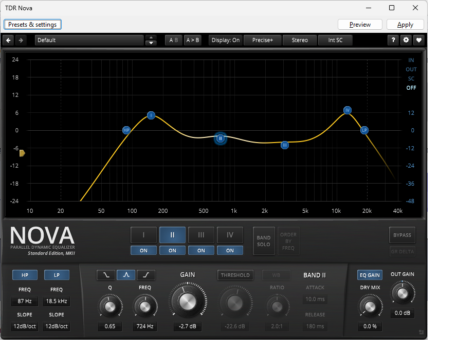

Rather than using Audacity’s native effects, I used plugins added to Audacity
The [u]free[/u] version of TDR Nova plugin does equalization and multi-band compression, (compress bass only).
The [u]free[/u] edition of Couture plugin does expansion, (reduces the room reverb a little bit).
Acon’s DeVerberate is not free. Kills reverb, but it adds computery artefacts. Use sparingly, if at all.

That explains it. The standard 100Hz roll-off is not going to help much: room is resonating at ~130Hz
https ://manual.audacityteam.org/man/spectrogram_view.html

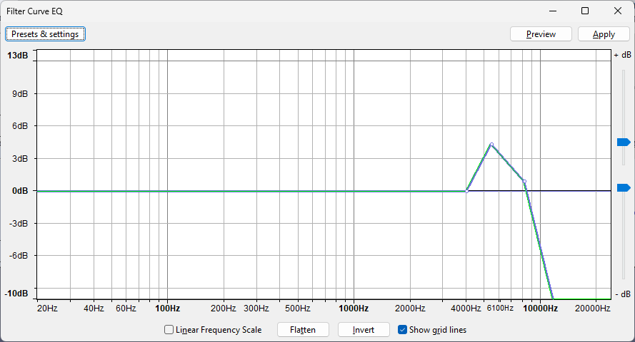

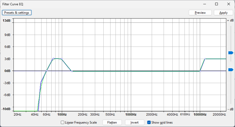

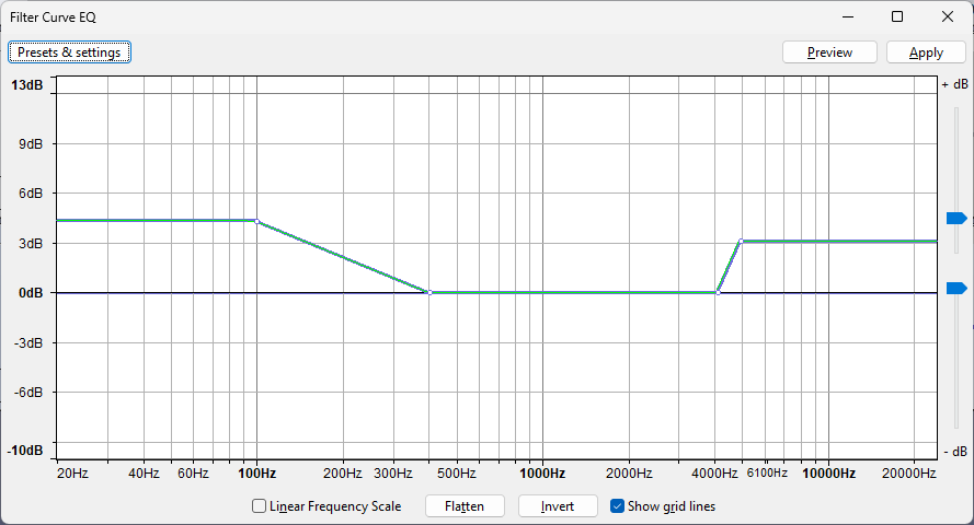

Just to give you an idea of what my Filter Curve EQ looked like (used in the video), this is how everything was set.
This was the last one that I came up with, I had used it for a future project.
This was one that I had been using, for an older video (or 2), taken from Josh Meyer’s tutorials for Audacity via YouTube.

I actually used TDR Nova, amongst a number of other plugins, and even though I’m certain I’m using it incorrectly. I think I might have used this for that same video.
Trebor, I don’t know how I’d compress the bass only.

This EQ will make the 130Hz resonance worse, (it may even be the cause).
Can only get away with a bass-boost like that (to increase the gravitas) if you are recording in an acoustically dead room: one with zero reverb. (Most room-reverb is in the bass frequencies).
If you omit that type of EQ that alone could solve your excessive bassy-ness.
Correct: #2 is “TDR Nova then Couture”, (the order matters), the 3rd is Acon DeVerberate alone.
You may not need to do this if you omit the bass-boost EQ(s)

Trebor, would you have a specific preset for the Couture plugin? If not, any suggestions on the settings I would use; similar to how you applied them in that sample (FLAC file)?
Also, just to be clear, the #2 TDR + Couture (together), is an option to use on its own, whereas #3 AconDeverb only is a secondary/alternate option to use; and not TDR + Couture + AconDeverb?

I have the old version of Couture: the current version one looks different from this …
Correct : #3 is Acon DeVerberate alone. #2 is TDR Nova followed by Couture.
