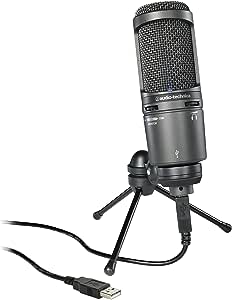

There is a USB version of AT2020 which plugs directly into the computer.
If you used the USB version, (no audio interface), Audacity could “see” that it was AT2020.
USB plug

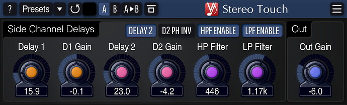

You can add stereo-ness in Audacity , a/k/a pseudo-stereo …
https://wiki.audacityteam.org/wiki/Nyquist_Effect_Plug-ins#Pseudo-Stereo
https://www.izotope.com/en/products/ozone-imager.html
https://www.voxengo.com/product/stereotouch/
But it could undermine intelligibility if it’s over-done.
