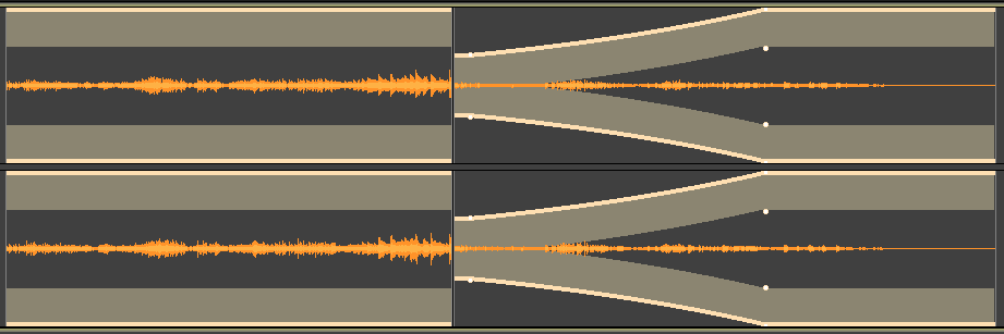

Second bug: When using Envelope tool, the left side of the audio (most of the time) becomes louder. How to produce this is explained in the attachment.

That’s a feature, not a bug : there is a split in the track, so the left side is separate …
Nope, that’s not it, this is what it would look like:
Before Mix and render:
After Mix and render:
Left side of the split becomes louder by a random dB.

It’s possible to (accidentality) set the envelope to above 1 …
Still not it… I am really careful with my edits, and I couldn’t possibly mess up that many times. I always go back when this happens and check everything.
Could it be the mix-down contains more than the one stereo track shown,
e.g. includes another track, which is identical to the left, so you get a double dose on mix-down.
Nope, it can be done with only one track … :confused:

Update on how to reproduce 2nd bug:
  1. Split a track into 3 parts
  2. Using the envelope tool, create a fade in effect on the second split, like in the original image.
  3. Copy the 3rd split and paste it back onto itself.
