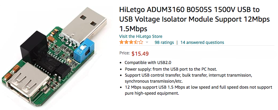

If I connect it to an USB power bank (no data connection to the PC, just 5V coming from a battery) it’s dead silence (yes it’s powered, I can hear perfectly the sound coming from the mic crystal clear).
So I guess the Audiobox isn’t filtering properly the 5V coming from the computer’s USB (which usually are full of noise, especially in the high frequencies).
Other than that the Audiobox sounds likes a decent interface, but the noise/hiss coming from the USB and leaking to the recording and headphones (and probably speakers if I had one) is a problem… I wonder if Behringer or Focusrite do a better job filtering the USB’s 5V or if I should consider getting either an USB filter or a USB hub with external power supply.
The USB filters seem to be a bit on the expensive side (50-150 € for the ones I found online). I never had one, so not sure how efficient they are…
Powered USB hubs are cheaper, but its PSU might be noisy too…
