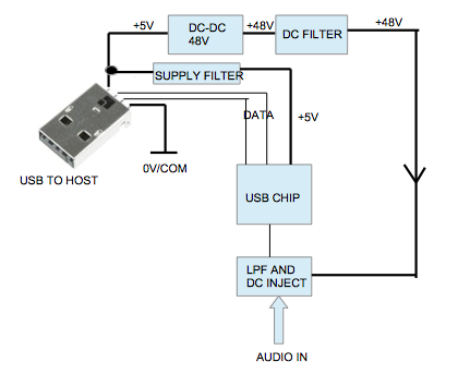

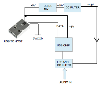

Consider this scenario…
Simplified block diagram of the average USB audio interface (only input path shown).
The 48V DC generator will most definitely have some kind of filtering, however, they could easily skimp on the
filtering of the DC to supply the actual USB chip.
Ideally, it should be as follows:
The better ones probably include a bifilar choke so that even the 0V/GND will also be filtered to a certain extent.

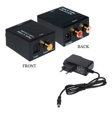

My TV also has an optical audio out, so following your previous suggestion, I’m now thinking about buying a small/simple DAC for connecting that optical out to the speakers (Edifier) I have there. The FiiO D3 (D03K) sounds like a good option for under 30 bucks. For that price, I’m not expecting it to be amazin, but it should be a good improvement over the TV’s internal DAC, for a very low cost.
I think you will be pleasantly surprised at the difference between it and the TV’s built in DAC.
Using this exact “no name” unit which I paid like 12 bucks for.
It has optical and coaxial inputs, just using the optical input.
Yes, it was your previous comment that inspired me to get one of this.
I saw “unbranded” ones, selling between 12 and 18 euros, but it’s always a bit of an added risk. You never know exactly what you’re getting… You might be just throwing some money away…
I might be paying an extra for the same hardware, but it’s not a huge difference (well it’s twice as much, but at such low price, twice is not that much, is it?). With the branded one I’m a bit more assured that I get what I’m expecting…
I haven’t ordered it yet, but it’s on my shopping cart :slight_smile:
